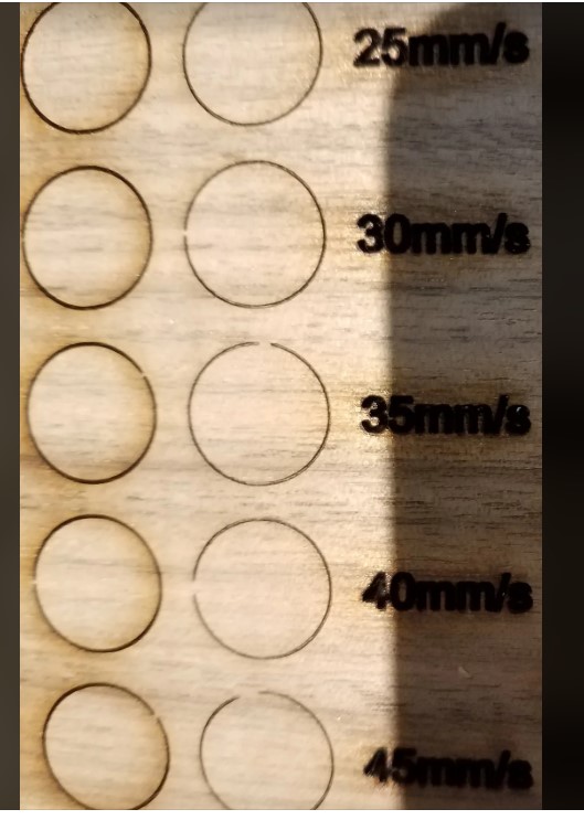

This is what the tech rep told me… But so were talking about the same thing, see the picture below. These are the tabs I am speaking of. How do you create this??
Looks like that it is part of the file, and not the export.
Did you actually break the lines of the pieces you want to have tabs? You can’t just erase a tiny segment or put a tab box (white fill, no stroke) where you want tabs. They’ll look like they’re there but they won’t be seen by the GF. You need to actually cut the line segments out. You can do that manually or using a small box shape you paste and union so the line gets replaced by the unstroked box.

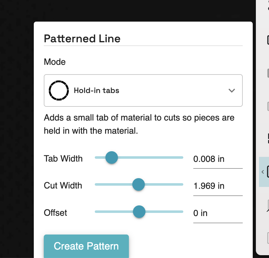

One of the templaes available in the premium tools is a pattern to create hold in tabs.

This is what I’ve been looking for!!! This definitely worked. Im going to test cut it now. Does GF give you the option to choose the amount of tabs and move them around?
I had not thought of it that way, but what you are creating is just a dashed line. Regular dashed lines from Inkscape or others transfer as solid lines without special trearment so using this tool in Premium you can have all sorts of fancy lines with dashed being the simplist.

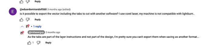

Thats what was happening to me. I create tabs in light burn and they dont transfer over to GF. Hopefully GF improves this feature. I’d like to manually place tabs in certain areas and not in a delicate part of the piece to avoid breaking the material when pressing it out.
Lightburn likely has a gadget, just as Glowforge. The problem is that nobody has the same gadget. You can still use the hard way of actually breaking the line, or the Glowforge gadget if you have premium. If you are doing a lot of retail sales, premium can easily pay its own way.

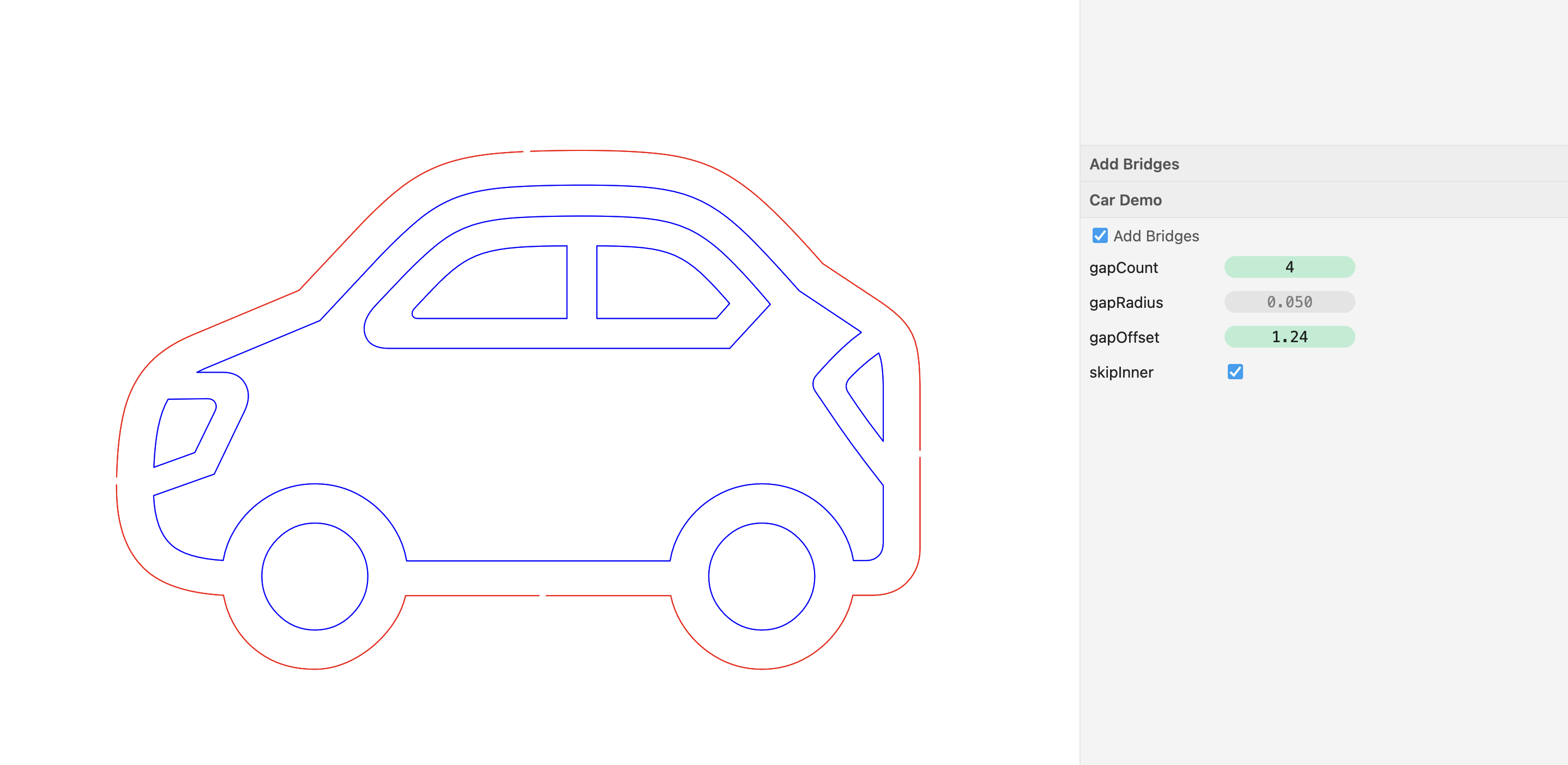

That’s basically how I have it set up in Cuttle. The difference is I am using circles for the boolean operations.
