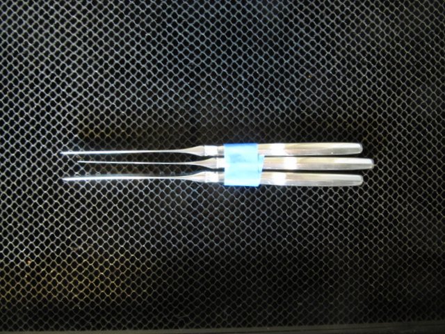

Did you happen to already check the tension of the belts in your Glowforge? My apologies for not asking this sooner. When pressing lightly on one side of the belt, the other side should not move.

Please reply with a photo of the belt if you are unsure about the tension. I’ll be checking in with one of our team’s top mechanical experts early this upcoming week to check and see if there are any other steps we can suggest.

I tested the belt tension as suggested and can see no motion of the lower section of belt when pressing the upper section. This was true for both belts in the 12-inch direction and for the gantry belt in the 20-inch direction.
What should be done next?

Picture of a 198.0 gram (3 knives taped together) weight pressing near the center of the left-side drive belt. All three belts feel like they have similar tensions.
IMG_5104
IMG_5105
