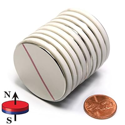

I think I read that people are using really strong magnets as hold downs, any recommendations for good ones?

That’s how I hold down the medium proofgrade and use to register a piece so it doesnt move for jig type operations. These are strong and would work well.
@curt paid me a visit and came bearing some bigger ones as gifts, not sure where he got them.
Same place
Those are bigger, but not as strong? 8.3 lbs vs 18.
I use the ones he gave me to hold down corners of warped material, the magnet halfway on the material, so it is sitting slanted on the edge. They are plenty strong… see the spacers between them in the link? If they weren’t there it almost takes a tool to separate them.
