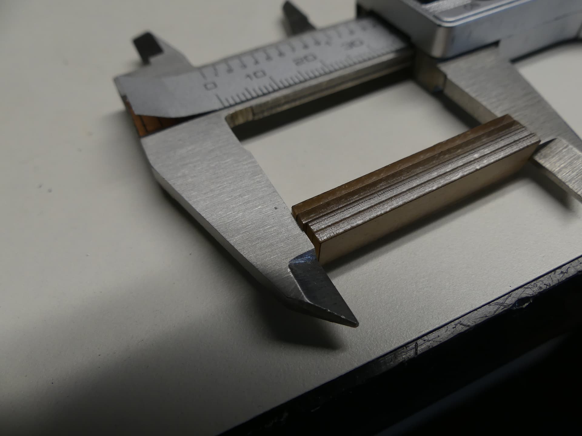

Measured the two piles (fits and don’t fit): 37.2mm for fits and 37.6mm long for the ones that do not fit. Not a continuous range of lengths, but two distinct sets of lengths.

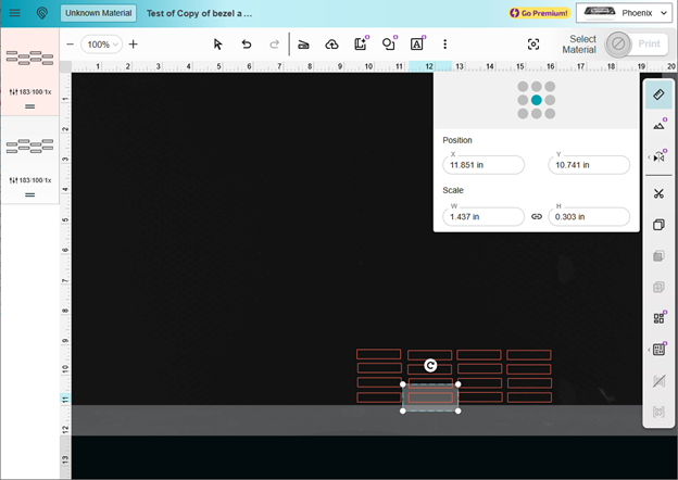

I found some additional material and the issue is repeatable.
Down to a simple 4x4 set of rectangles.
The two outside columns are consistently larger than the two inside columns.
Not sure how to tell current exact size, but the “Scale” shown is the same for all of the pieces.

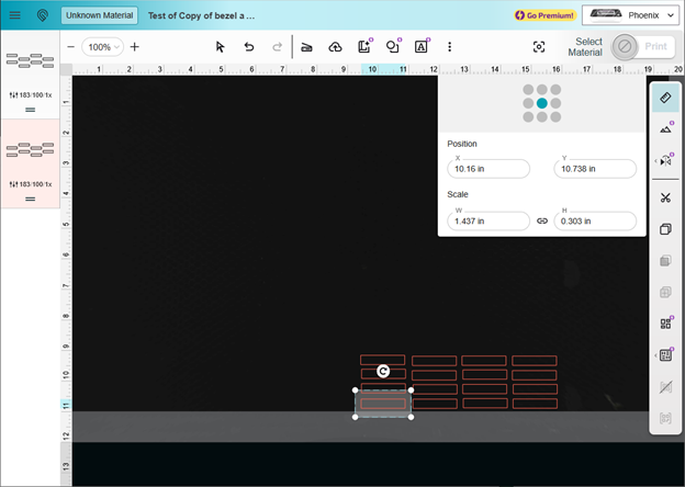

I’ll try swapping the first two columns and see if it follows the location(ish) or the parts.
I swapped the left two columns of parts and the results of size did not change.
The length (same as width in this orientation) was consistent: the outside two columns of parts (8 total) were identical and the inside two columns of parts (8 total) were identical.

You can see the coordinates of a couple of the parts in the screen captures earlier in this post, in case it does not place it in the same location for you.

I have re-printed precision parts all over the bed on scraps or to save as much material as possible. The machine will never resize an object, and the camera has nothing to do with scaling - it’s merely for approximate object positioning.
You have a mechanical issue if I objects are not printing identically at any position on the bed.
Then most likely I have some mechanical issue in the X (horizontal) movement.
The movement feels fine when sliding the head back and forth with the power off and the belt has reasonable tension.
The size change is small and repeatable, so debating tearing the machine apart to look for the cause or just live with the error.
