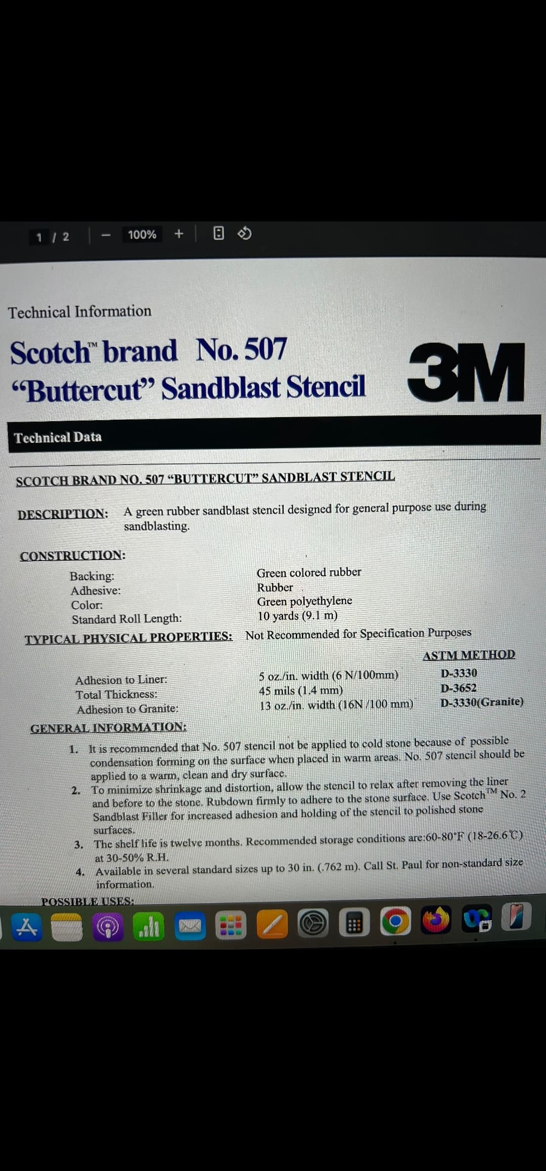

Has anyone tried cutting Scotch brand “Buttercut”? Image of the technical data sheet attached.
Buttercut has never been mentioned on the forum before. You may be the first.
It says right on the SDS that this is a polyethylene film with a rubber adhesive backing. Luckily this has been covered many times.

Everything you need to to know is here already. I hope you post your results – I’d love to hear how it turns out, buttercut seems to be new to the community and it’d be great to learn more from someone who has tried it.
