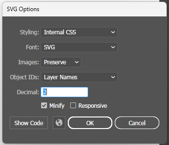

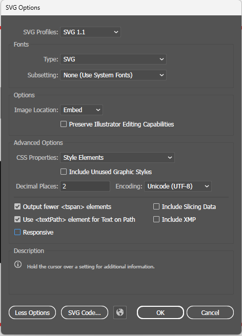

it’s not in settings, it’s in both the export to SVG and save as SVG dialog boxes. just make sure responsive is unchecked. and dangit i just noticed that my decimal points got reset to 2 recently. i hate when they reset panels like that in updates.
Save as:
Export

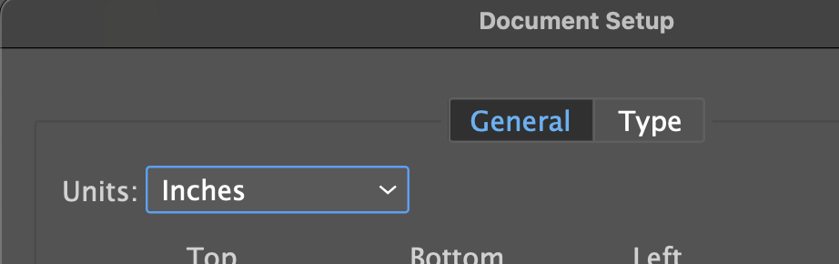

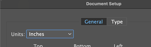

That said, your file did give me a clue as to what I think the problem is. In order to export with physical units, you need to have your document set to physical units (e.g. Inches or Millimeters). I suspect yours is not.
If that is set to pixels, it renders the responsive checkbox meaningless, and would also affect copy and paste.
I did a video a while back (good lord, 7 years ago?) on setting up Illustrator. I really need re-do that with a modern version and the stuff I’ve learned since.
