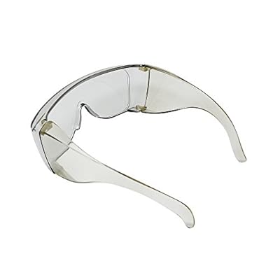

I have these:

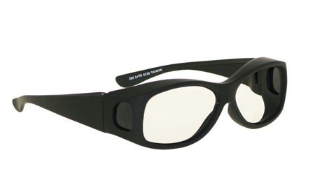

And these:
The Redsail is Class 4 and the K40 should be since there are no interlocks preventing its use with the lid up
BTW, they’re both 6 ODs which means they attenuate the laser transmission by a factor of 1million (.0001%).
