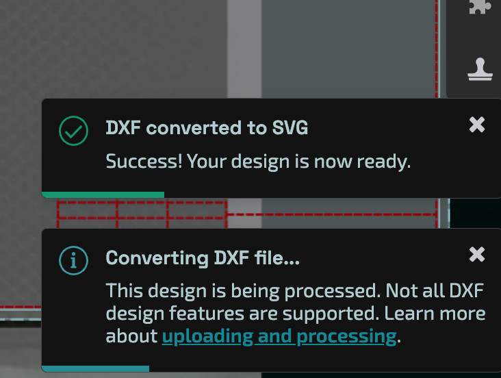

After the drag i got:
Then after a minute, this appeared:
The design is very simple, just a few lines and arcs (attached)

Interesting… your file gives me the same error, but all of the ones I already had (and tested) are working fine, even some pretty complex ones. This one is a model of the Eiffel tower and over 3MB. It took about 20 seconds to upload, convert, then render in the UI.
I’d try creating a new file and copying the bits into it - I’m betting something in your original DXF has gotten corrupted in some way.
There’s a cloud converter out there that should work
Thanks everyone for suggestions. SolidWorks is a very reliable DXF generator. I suspect GlowForge is having dificulty interpreting the file (there are many versions of DXF and not sure if they favor one or the other) I did find a work-around; Open the dxf in Solidworks. It is converted to a drawing file. then save it again as DXF and now GF will import it and convert to SVG. Painful, but it works. Oddly GF only rejects certain DXFs generated from the same part file. Some with only 6 lines and 2 arcs…
