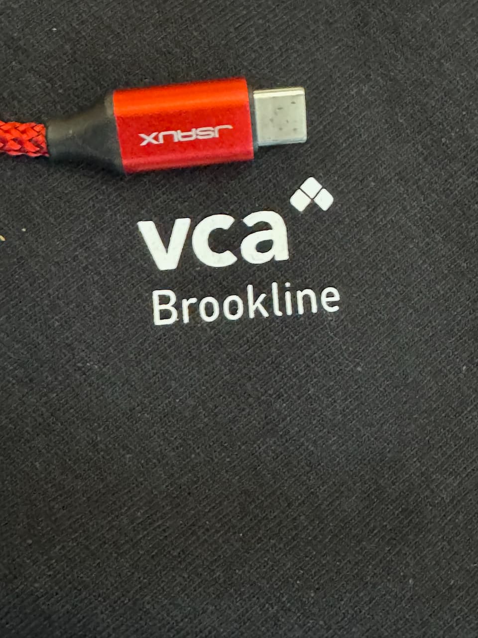

Sorry didn’t have a bannana but everyone knows the size of a USB-C connector. The detail from this iron on material is impressive (weeding that was awful) but the super thin lines on the VCA logo is impressive
Turned out nice in spite of issues. I have used it a few times and had it cut through at times as well. As you said, it’s hard to weed and get placed correctly when this happens. @dan is there an intent to create some nonironable “vinyl”? That would be great.
