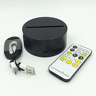

I’ve wanted to mess around with edge lit acrylics and finally got the chance recently. I ordered this on amazon, just to have something to start with before building my own. The base is slightly wider then medium proofgrade acrylic. I just used some gorilla tape on either side to even it out.
