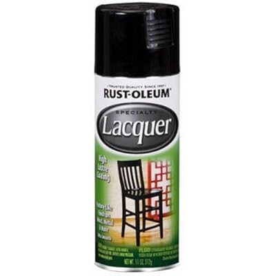

My best results came from an engrave at speed 1000, power 20, vary power, min power 20 (well, 19.8), 340 LPI. The goal is to just blow away the masking without making a deep engrave, otherwise the paint won’t get down into it. Then I sprayed it it with this stuff:
My painting was sloppy and rushed, so I’m pretty sure I could get nice crisp edges by taking some time. Those are very thin features: just 1 point around the outside edge. Scoring was not successful: I couldn’t find a power/speed setting that could cut the outline of a 1pt line while leaving it intact.

I’ve seen videos where Lacquer paint lasers well.
