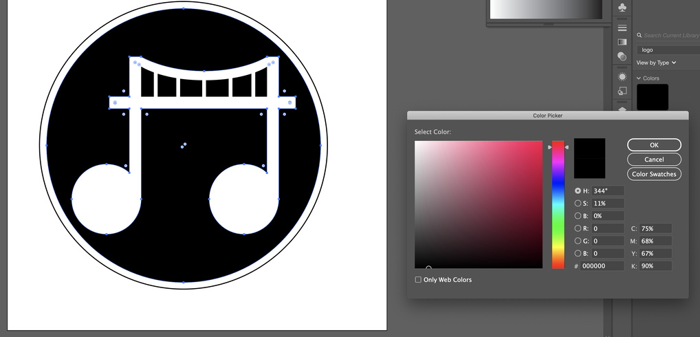

I am getting an uneven engrave depth on circular wooden pins with our logo.
I attached a screen shot of my Illustrator project and photos of the issue. I would greatly appreciate any tips on getting a nice, even engrave. I am using medium basswood hardwood the default settings.

The way the uneven parts are consistent and laid out I strongly suspect the file is the issue, though I could be wrong. Do you have anything in the file that corresponds to the uneven area boundary? My initial suspicion is either a color issue that GF is reading as a less intense engrave or a double layer where one area is engraved twice.
Hey Steve;
Welcome to the community! My first guess would be that part of your “black” background is at 000001 causing that ridge. It’s possible that’s an artifact of the wood, but I’d double check your file first since that’s fixable.
Thank you for the response. It is a solid black fill #000000. Do the CMYK values all need to 100%? Thank you!

It is consistent on every piece of this design and I have done a few other designs where everything is even for every piece. I can’t figure out what the difference is in my file since its a solid black fill. It begins by engraving the desired depth and then about 45% of the way in it goes deeper, almost too deep that it’s a cut, for the remainder of the design. I am using the preset settings for the proof grade material I am using.

I’m presuming this is an .svg - but since it’s solely black and white, maybe save it as a raster?? It really does seem to be odd, and the issue-with-wood wouldn’t be repeatable :-/ Though, since you’re testing now - try running one rotated 90 degrees? If it still has the lip going across the grain than it’s definitely in the file. If it doesn’t have the lip that’ll prove wood-issue
This is Proofgrade, so this consistent line is almost certainly with your artwork. The Proofgrade plywood is an MDF core so it will be pretty even throughout. The hardwood would not provide this type of behavior as the grain would move the difference in engrave levels around the part.
We can see from the photo that the engraved areas between the legs of the note and in the bridge are shallower than the rest, which points to the way the image was made and not to material.

You’re getting a lot of lines from uneven engraving in places as well. Is this Proofgrade Basswood or Maple plywood? PG Ply has an MDF core so it should be much more uniform. Also - which PG settings specifically? There are Draft, SD or HD graphic options.
The picture with 2 pins in it is the PG Maple Ply. The other pictures are the PG Basswood. I have been using the default SD settings. SVG uploaded thank you!
