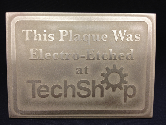

May I suggest another option for actually etching aluminum, not with your :glowforge:, but using your :glowforge: as a tool to create a chemical etching mask.
You can follow any of these instructables:
The first uses a solution of water and copper sulfate and table salt only.
The second uses a solution of water and table salt with a low voltage direct current electricity source which I consider cleaner and easier.
  • Clean your aluminum piece with solvent to remove any residue.
  • Spray your piece on all sides with 2 or 3 coats of black paint that will serve as mask.
  • Use your :glowforge: to etch your image on the piece to vaporize the paint and leave the exposed metal. This will be your etching mask.
  • Follow the chemical etching process in either instructable.
  • Clean your piece.
Please share with us your result if you decide to try this.
