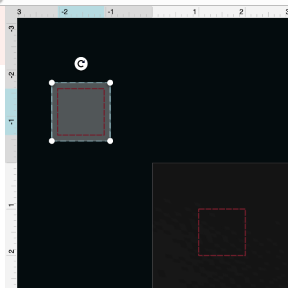

My original topic was closed after 30 days, so I can’t reply to it but I found new information on my error and hope someone can help. The export is only 25% bigger IF any part of the image is outside of the bed’s printable area. For example, if I have just printable area stuff in the file, no problem. If I have a second print waiting off to the top left that I move in once I am done - that is where the entire image distorts to 25% on export. Most of my files have 10-12 different “bed area sized plates” in the outside area so I can swap them in for each step. I desperately need to export my files, but I cannot export any that are larger than the printable area, and I do not know what to do. To copy each image into its own file would take hours and hours. I have 30 files with 10-15 images inside each. Is there really no way to save and export these without it distorting the size?

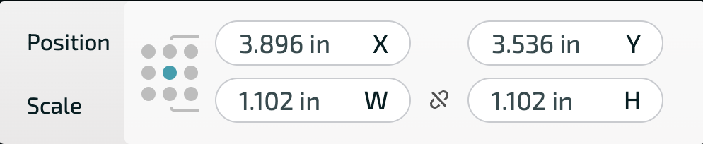

I have been trying to backup my files since some I have used for years have been lost due to a failed hard drive. No matter what I try, the exported file from glowforge is scaled up about 25% which is useless - no I cannot just rescale it to the correct size as these are sensitive files and that would take days to do all the files.

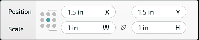

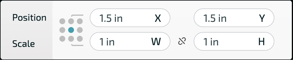

To show the issue I made a 1 inch by 1 inch square and uploaded it to one of my files.
I am using the export SVG button in glowforge app right after the “premium” features.
I have tried downloading and immediately re-uploading without touching the file, so it’s not a program rescaling it. I use Inkscape for reference, but the image is already scaled 25% larger even with simple export/import and no touching.
I had the premium free trial and it still did this.
I have tried searching the forums, but only find people with upload scaling issues. My images upload just fine, it’s only the export to back up the images that have an issue.

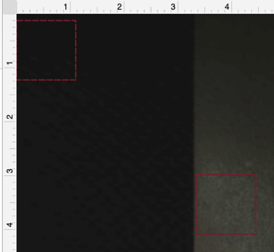

Below you can see the file in Inkscape - the 1-inch square is now 1.25 inches.
The other is an image of the laser bed after export and immediate reupload without touching it, again the square is now 1.25 inches.
