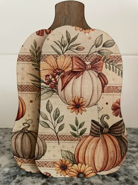

I am using the Build a Pumpkin Popout Card files from the catalog to make larger pumpkins to UV print. My problem is that enlarging the file also enlarges the skip in cutting that holds the piece into the backer board. I can still pop out the pieces despite the enlargement but it leaves behind areas that have to be sanded smooth and then redarkened to match the rest of the cut edges. Any suggestions on how I can convert this to a solid cutting line without the skip? I am including an example of one of the finished pumpkins.

Thank you for taking the time to reply. You confirmed my own conclusions so at least I don’t feel like I have overlooked something obvious. Unfortunately, my search of the internet hasn’t yet turned up anything similar that I like. I just need a simple 3 layer pumpkin so that it will stand on its own and is easy to print on. I will try contacting the designer to see if they have the file available elsewhere. Thanks again!
