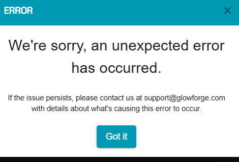

I am having the SAME issues, and it’s not an old file issue or anything of the sorts. I keep getting the same error and NONE of my uploads are successful, cant even get a simple image that I use regularly to upload. I have turned off my Glowgorge for hours, restarted my computer, checked my connection, switched browsers, and then some. I am having almost the exact same problem as you are, except I cant even get a simple circle to open or cut. Crazy thing is, this JUST started a few hours ago. I was using my Glowforge at 5 o’clock this morning before the kids woke up and it was running fine. Shut it off, then came back to it around 3 and No luck. Anyone else having this repeated error problem?
Just tried again with a glowforge imported image (form the magic maker) and same error occured. Using Chrome by the way (as always) but same thing happened in Safari a moment ago.

I determined it was an ad blocker we recently installed. I disabled it and all is well.
