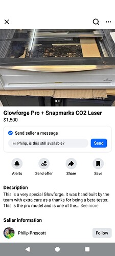

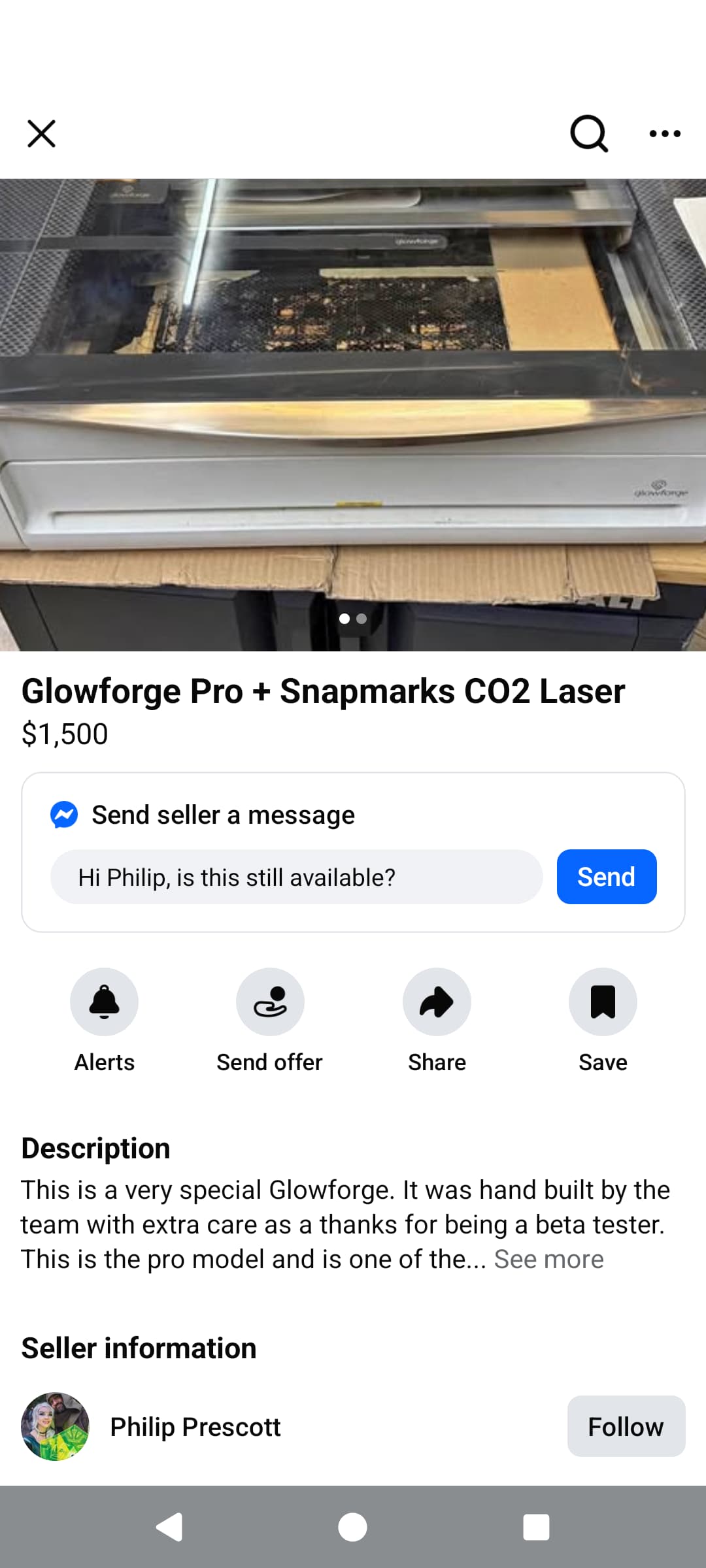

There’s another Glowforge with Snapmarks enabled for sale:
