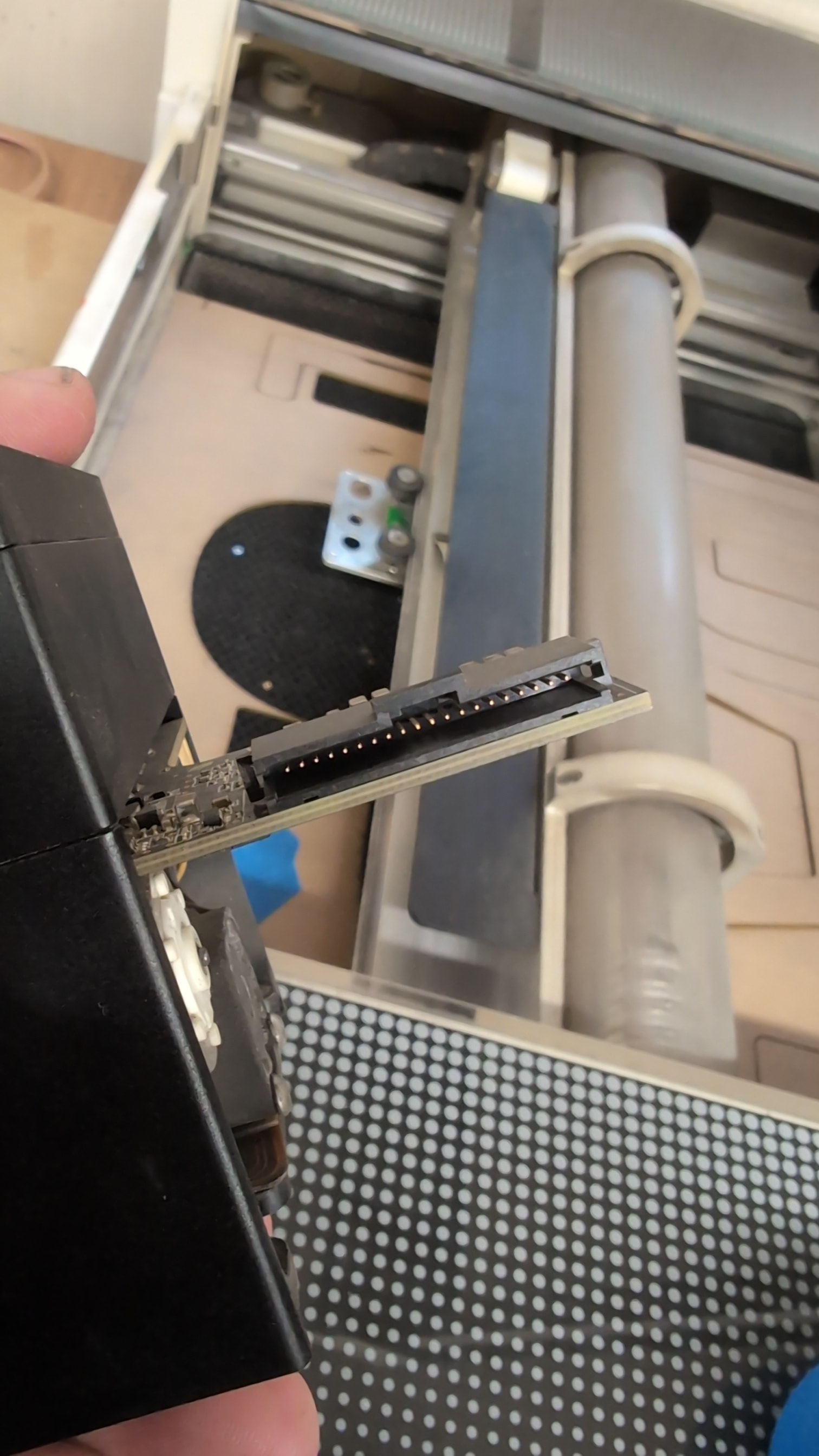

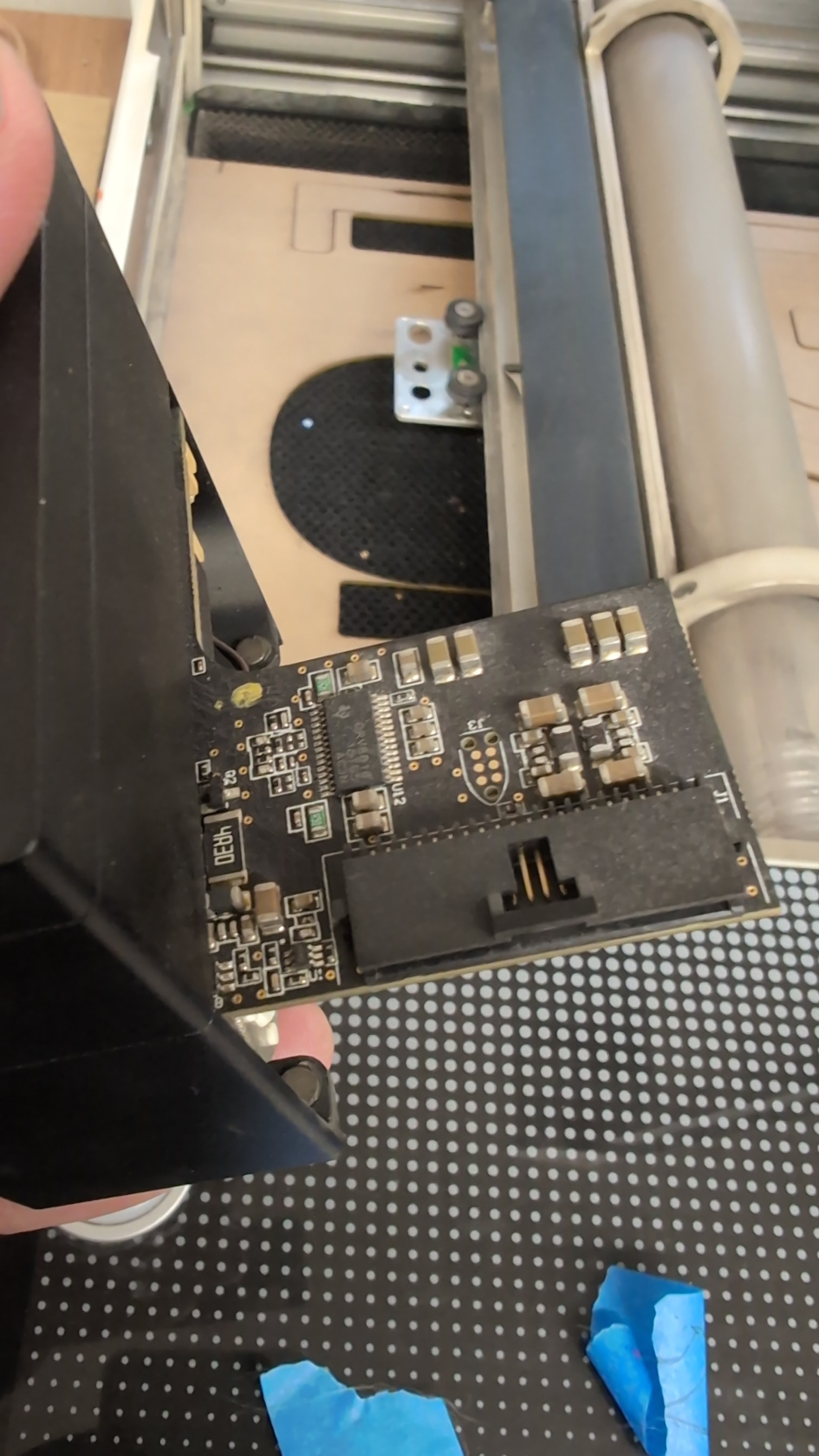

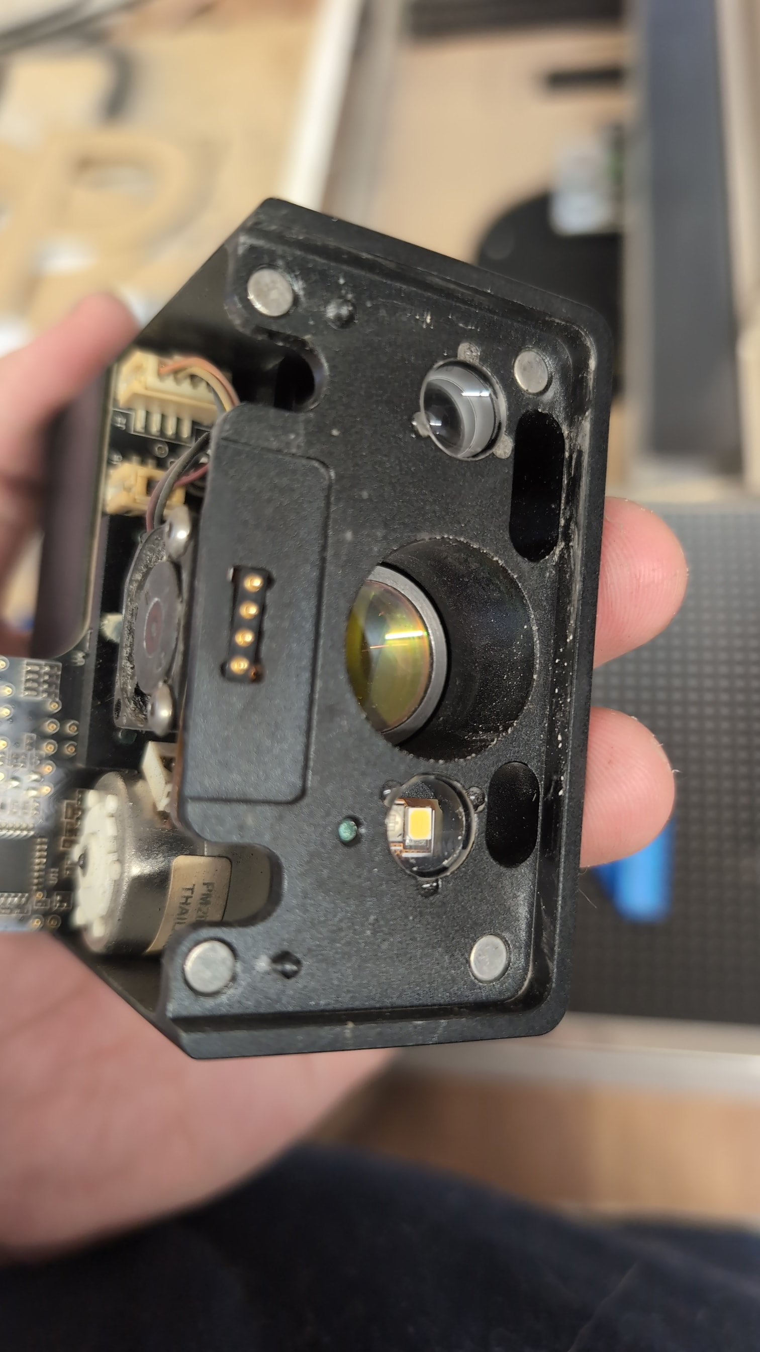

I’ve cleaned everything and everything seems to be visually okay on the machine. It was working all day and then just stopped. Materials are flat, debris is out of the machine, I’ve reseated the head a few times.

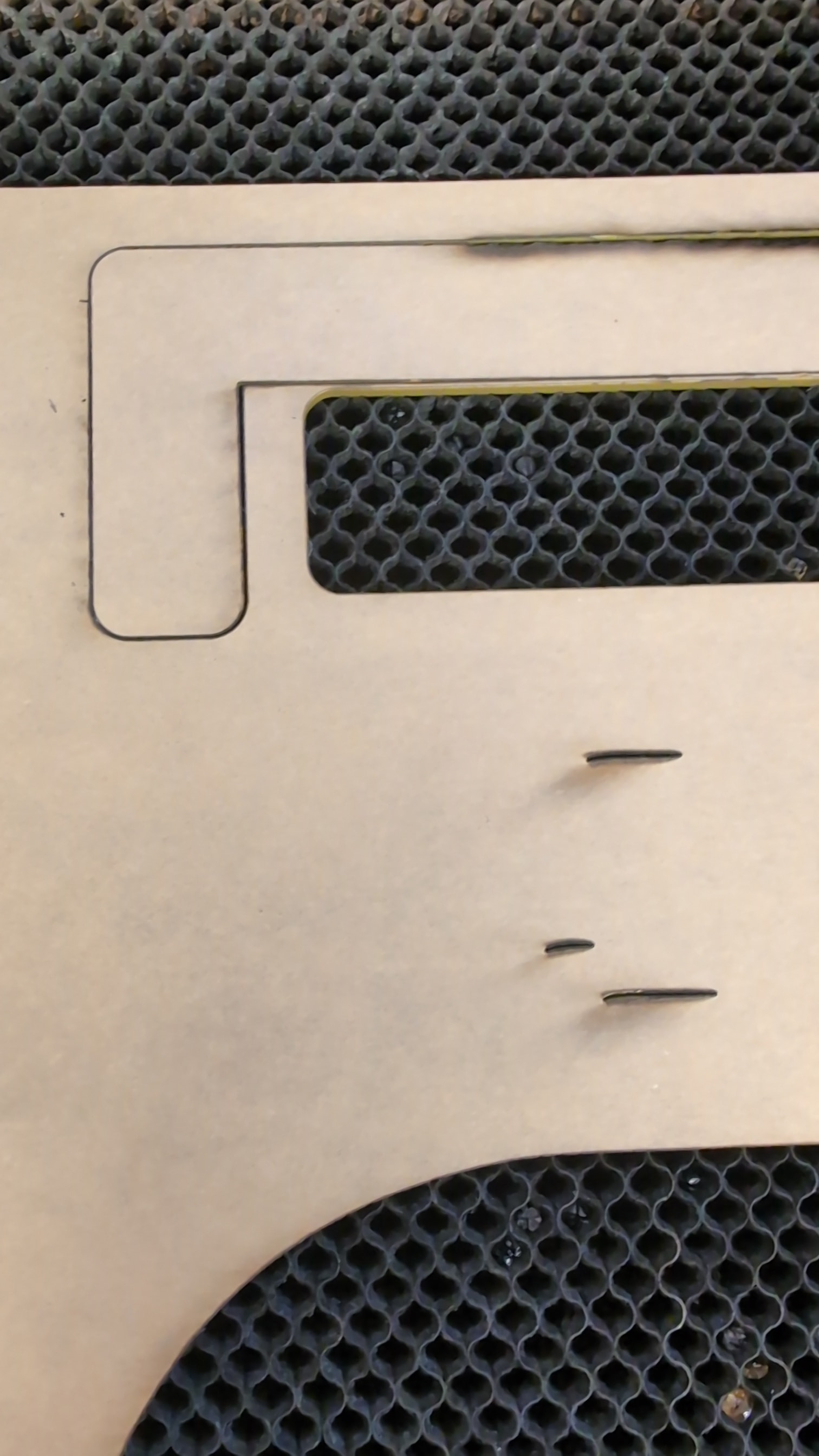

Here you can see the difference between where it was working and where it stopped working. I was able to get it to work once which is why you can see the clean line but I haven’t been able to get it to work since

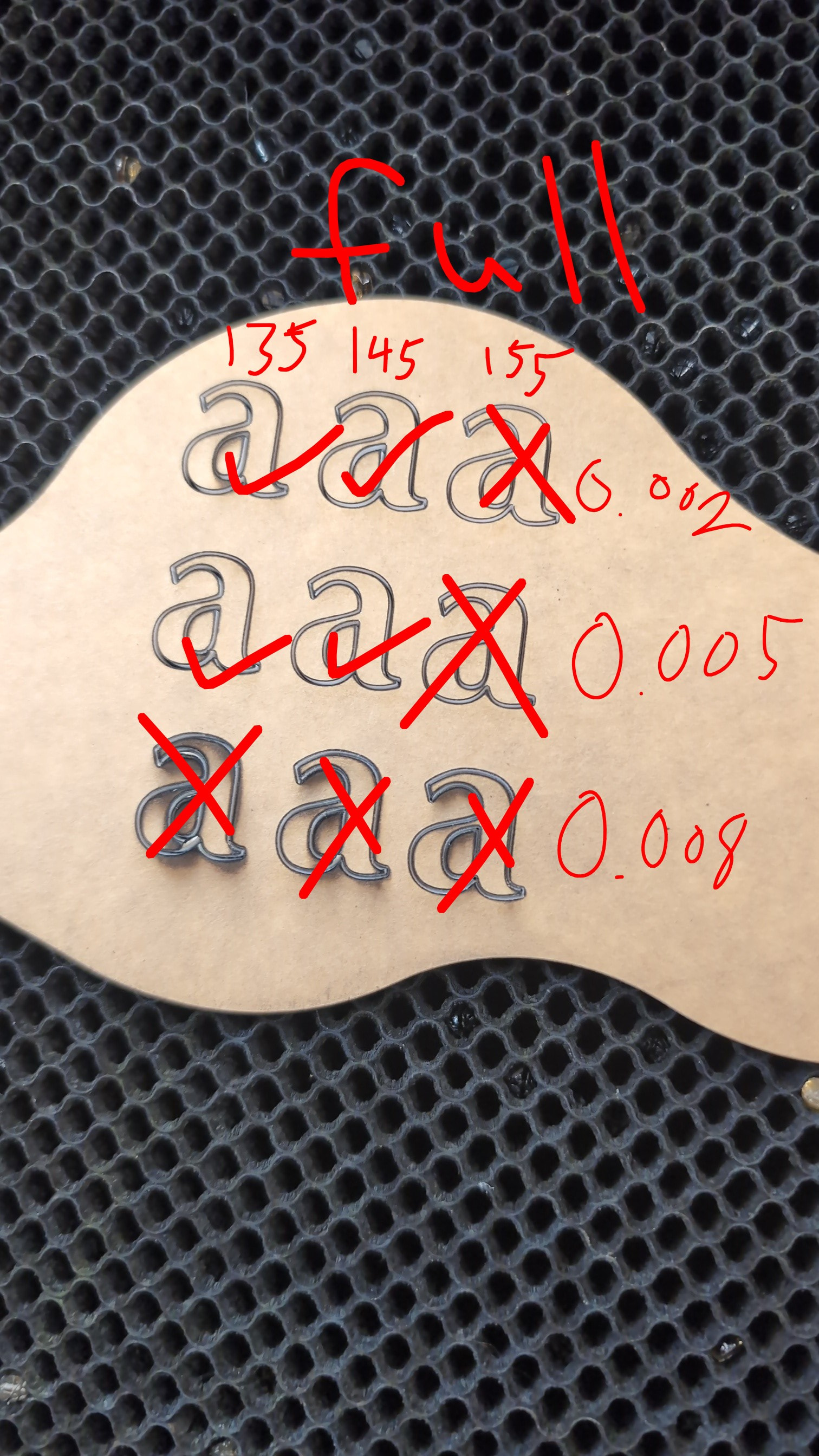

Update, I have found that if I set my material thickness from What it should be (0.115) in to 0.003 in I get cleaner result.
