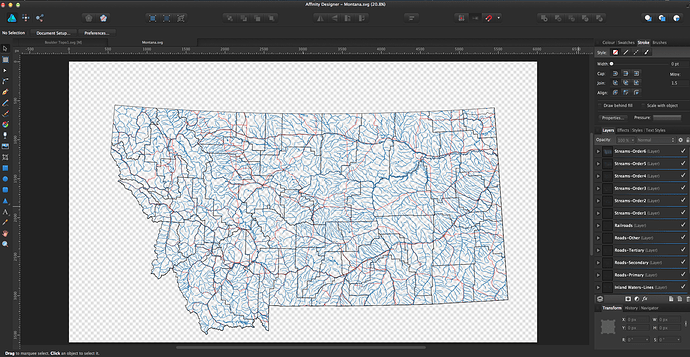

What is difference between Inkscape SVG and regular SVG? Is that why SVGā€™s sometimes saved in Inkscape and opened in Corel have some wierd 'growth". Like someone grabbed a node or two and wandered away, dragging it with them?
Probably. Or sometimes you canā€™t open them in other software. Inkscape SVGs are proprietary, and canā€™t be correctly opened in anything other than Inkscape.

I regularly open Inkscape SVG files in Affinity Designer and have also opened them in Illustrator but they lose their layer names in Illustrator. Here is a Montana map Inkscape Illustrator file opened in Affinity. Note how all the layer names even come thru!!!
Good to know! (Theyā€™re building the interface for AI, and it doesnā€™t do very well with Inkscape SVGs, as you pointed out.):slight_smile:
