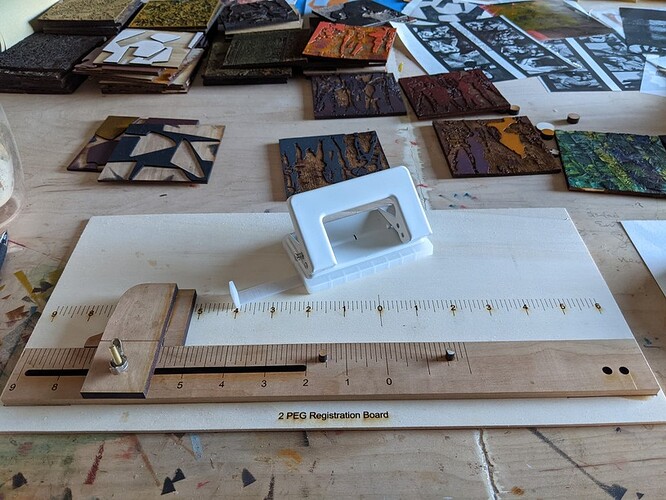

I’ve tried a couple of registration approaches - and built jigs for both. The one that works best is a 2 pin approach (not unlike that used in old time cel animation stands). I use a small hole punch for the source paper but I assume a standard 3 hole paper punch would work as well. Here’s a picture of the punch and stand
The speedball professional oil-based inks seem to work well for me. The water-based ones not so much.
Nice!
Oh that’s excellent! Kinda like Ternes-Burton registration pins but more tidy. Thank you so much for sharing.

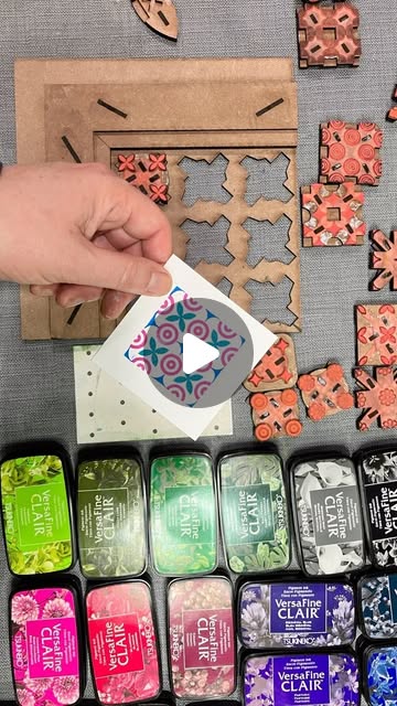

Here’s a gadget I made for a Make-n-Take at a print show.
Here are some examples of the cards. Each card uses 3 stamps.
https://www.instagram.com/p/C_WoBAfSoZs/
https://www.instagram.com/p/C63_o--pnbN/
Those are small rubber stamps. They were super addicting and easy to print because you can use stamp ink rather than printmaking ink. Great for cards, or things you don’t need to last forever.
