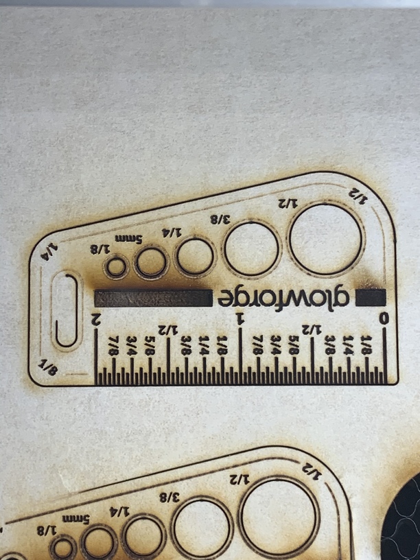

Hey all! The 4th attempt at a working glowforge arrive today! I was super hopeful, but am now dissapointed and frustrated. When trying to print out the GoGM it doesn’t cut all the way through. Things I’ve already tried:
Measured the wood with calipers and updated the accurate thickness in the cut settings
Cleaned all lenses and mirrors and bits
Machine is level and great
Also of note, the laser seems to also be “fading out” and will just stop engraving/cutting midsequence and not completing the whole process.
Could the GoGM file be corrupted somehow? I also attempted one print that i ignored all the engrave settings and ONLY did the cut sequences and that attempt worked and actually cut all the way through with zero problems.
HALP!
PS - pictures to come in like 10 minutes after I get them uploaded. :slight_smile:
Here is pictures of the cut that was completed without engraving at all. This was with normal PG settings.
The second picture is of the “fade out” where the laser cut out mid cut.

Here are more examples of the laser fading out:
It happens in different spots. Also, none of these are cutting even remotely close to through the wood.
I have reset the GoGM design several times during this process as well.

That is bizarre, but the only common factor here is the file. There’s no way it’s material, the way the beam is just skipping sections. Also, it cut fine without the engraves - so the machine is (should) be capable of running just fine.
So Jules, the last 2 printers that didn’t work would sometimes cut just random circles and simple stuff and sometimes not. It was hit or miss. My main issue is that for $6000 you’d think that the standard GF file would work.

a few things to try:
is the tray seated in the dents within the forge. Having the tray not seated puts the wood at an angle and that will make part of it out of focus.
is the material flat on the tray. if not same thing.
rather than measure the wood, use the set focus feature. see how that works
You know, that power fade bothers me. I find it impossible to believe that they could send four machines that all had power supply issues. But I also can’t see how a file corruption could cause it to fade like that.
I wonder if there isn’t a weak spot/break in the lid cable wires?
Ashleyn, tag me tomorrow whenever you get back to it…I might want to see a few photos of your lid cables. And i do have one other question…when you open the lid on the machine, are you opening it fully upright? (90° angle). (If you are…don’t.)
Angled bed or material might cause this:
… but not this:
… or this:
agree. this looks like multiple issues happening at once
… on her 4th machine, no less. Pretty sure the issues on the others were similar.
