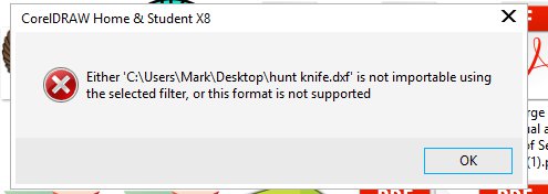

Well, that was a good thought but I exported directly from a sketch and no go still. I am using V8 home and personal, would that make a differance from the pro package?

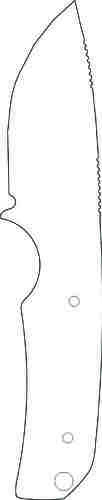

hunt knife.dxf (9.3 KB)
here is one, thanx

Okay, that convinces me that they pulled it out intentionally. Just a little adjustment to my workflow as it does PDF just fine.

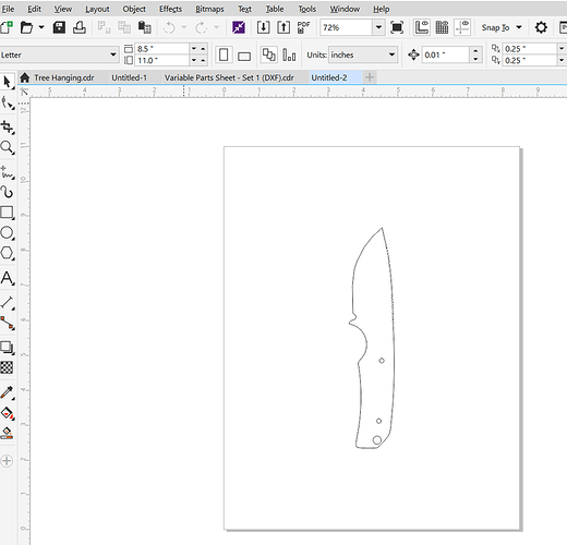

Here’s what I got:
I opened it and told it that it was a 1:1 size with inches as the base (vs. mm).
Just for grins I did an Import as well.
So either way worked with X8 - both Pro and Education (my wife also uses it). I have Home & Student around somewhere but don’t have it installed on anything now though.

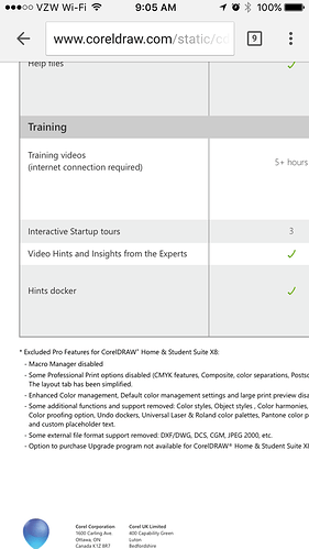

DXF compatibility seems to be a feature that’s removed from the Home and Student version according to the comparison matrix (http://www.coreldraw.com/static/cdgs/product_content/cdgs/hsx8/coreldraw-home-student-x8-comparison-matrix-en.pdf).

This is what I have been assuming but that confirms it. Thanks.
