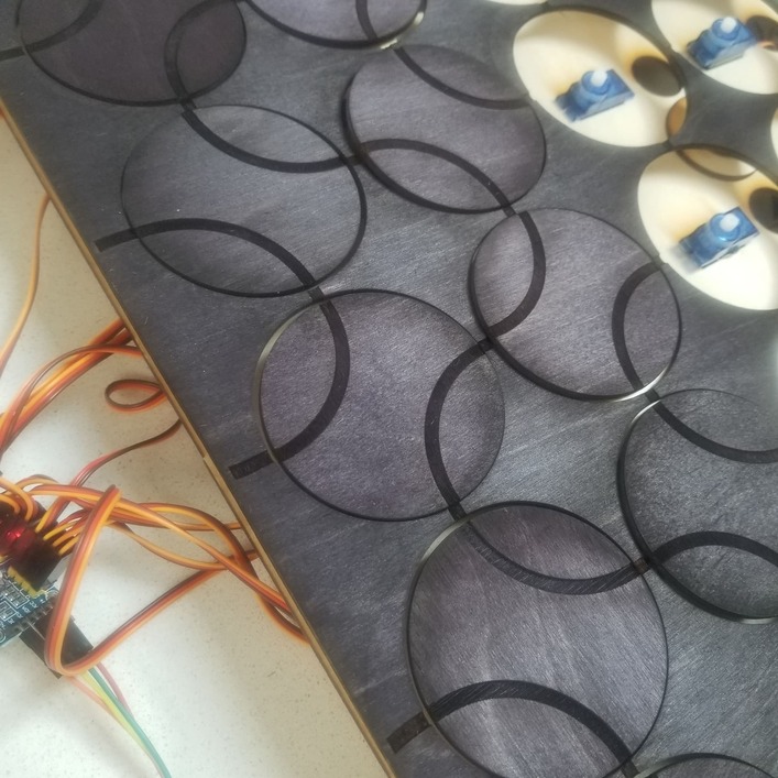

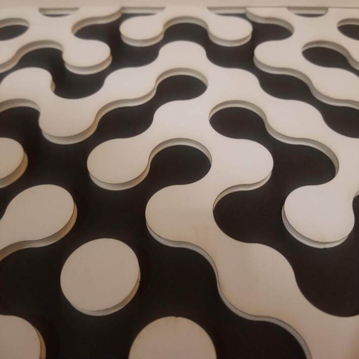

Over the summer, I played with a project using servos to create a moving image.
I abandoned it ( for now) mostly because it was loud and partially because the servos were not repeatable which was causing alignment issues.

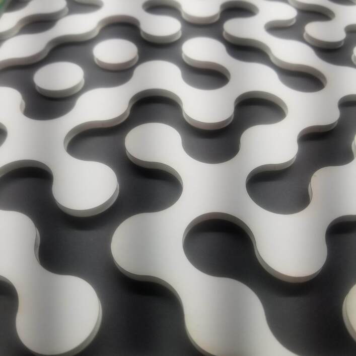

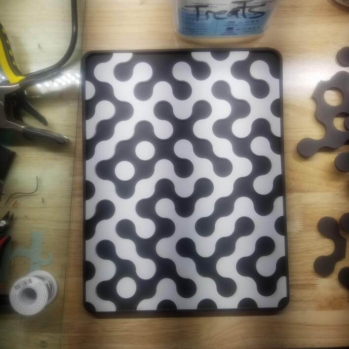

But that linked circles/arcs image was stuck in my head. So, today I made a few trial pieces to see how it would work in foam.
I like. It got that out of my skull and solved the noise and alignment issues. Next, I will be scaling this up to something just under 20 x 30 via the passthrough slot and making a few other tweaks.

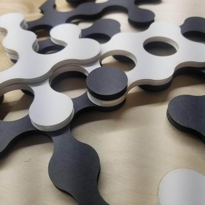

That is neat. I’m curious to see the black and white foams sandwiched together!

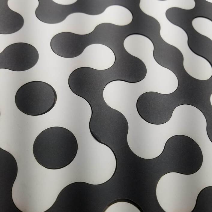

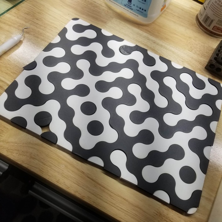

Combining the black and white as one layer was my original intent. However, the way the paper edges and the foam lost during lasering work together gives a great result with a contrast layer underneath. So, I stopped there in the prior images.
These are more like my original intent…(which I like less than uncombined)

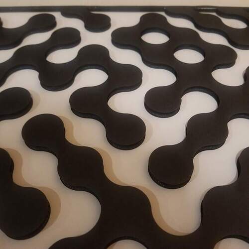

And then you suggested “sandwiched together” which to me suggested “stacking” so…

I would try stepper motors with Trinamic drivers. That should give repeatability and run in near silence.
This design is groovy! I love it! I also like the sense of depth created by the uncombined ones.
Only if you’ve managed to find foam core made of vinyl or pvc…it does pull back from the cut so judging “kerf” is a touch more difficult.
Speaking of - could you kerf correct?

Thanks, I will check those out. I see adafruit is offering a model with an output for position (analog) those might be a possible solution to the drift I was experiencing.
One could try to kerf correct but in my case, I like the way the loss of core material makes a curve from one face to the next. I do not think one could get a square edge with this stuff.
I think the Trinamic drivers also have an index output.
The SilentStepStick units I bought all have an index which can be used to monitor position on a driver level. It doesn’t account for steps lost though.
Another possible idea is to use a cheap position sensor like a Hall effect unit and write the code to move to index points.
You could also use a photo resistor and opaque material as an index wheel or even tiny holes in your pattern discs to do indexing.
