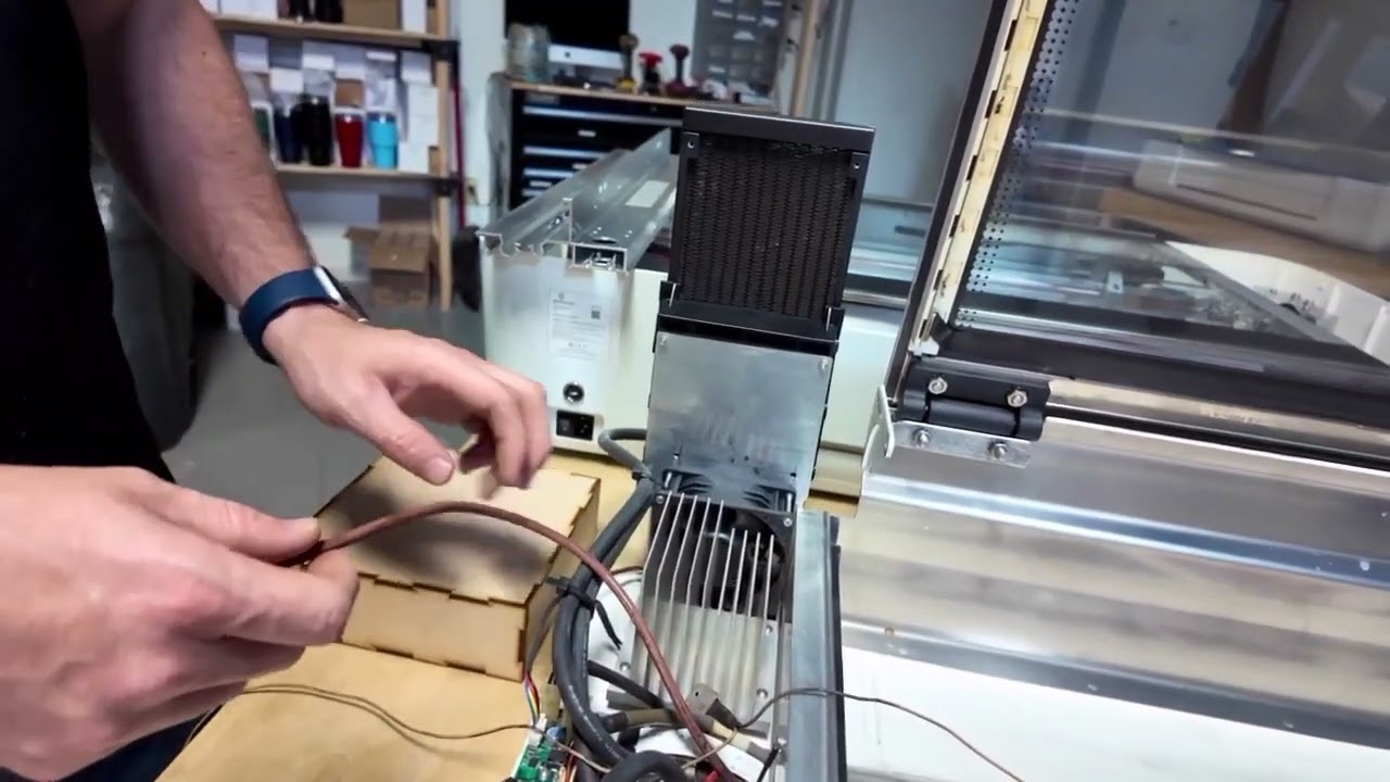

I submitted a ticket for support but just curious if anyone has experienced this and what your outcome was. My GF Pro was working fine all weekend. But this morning I went to cut my first piece and it went thru all the normal motions and then I pressed Start, and it sounded like everything was as usual but I noticed there was no cuts or scores showing up on my material. I noticed the Co2 laser tube didn’t have that pinkish glow so I’m wondering what might be the problem and if I’m in for a pricey outcome. This is my 3rd Pro since I purchased a brand new one in November 2022. The brand new $7k one didn’t last 90 days before they replaced it with a refurbished one - which lasted maybe a year then I had to purchase the next refurbished one. Seems like I recall the pinkish glow had gone out on that 1st refurbished one also. So I’m starting to wonder if this is something to be expected? I asked ChatGPT and it said normally you have issues leading up to a bad laser tube or it might be a problem with the laser power supply. I haven’t moved, loosened or disconnected anything and it worked fine till this morning.

Beyond that you might have a pretty common short circuit issue with your high voltage line to your laser tube. It’s possible to fix that yourself if you’re handy.

I checked the power on the last files I cut (the night before this started) and oddly enough the power was set to 1 on the cut section of that design (but I did not change it, so I’m not sure why the machine would do it automatically). So I changed it back to full power and still the same. It goes thru all the normal steps perfectly and then acts like it’s making the design but nothing is showing up on the material. There’s no errors on the program either. GlowForge support replied back that it’s “experiencing an electrical failure that cannot be repaired remotely and I could purchase a refurbished unit for $4k+”
