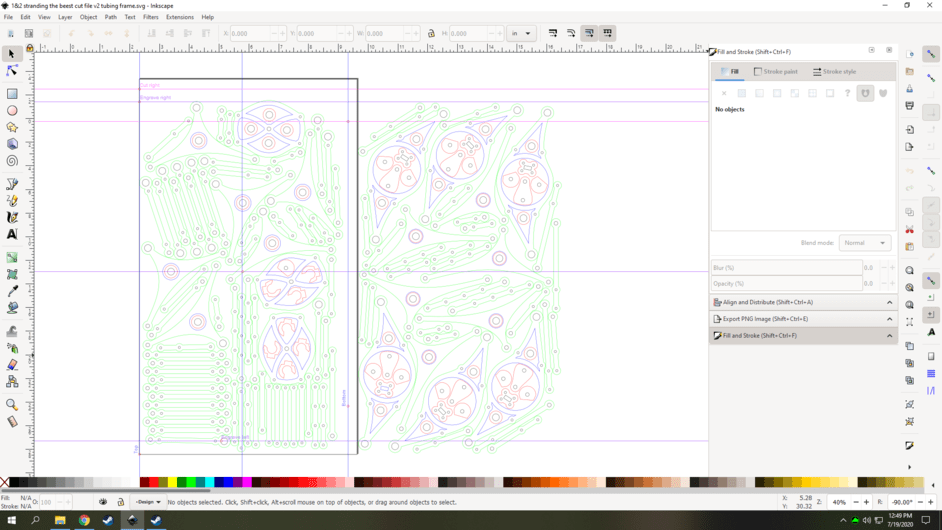

makes the strokes different colors to group them manually. like make all the things you want cut blue and all the things you want scored red. that kind of thing.
I will give that a try. Thank you!
This is an example of how i separate out my cut files so i cut the inside of parts before the outside using the same technique.
That makes sense. I just tried it and that worked perfectly. Thank you so much. I have been working on this since yesterday. I have been getting so frustrated. Thank you for the example and quick reply. Your help is so very much appreciated! Have a great day!
