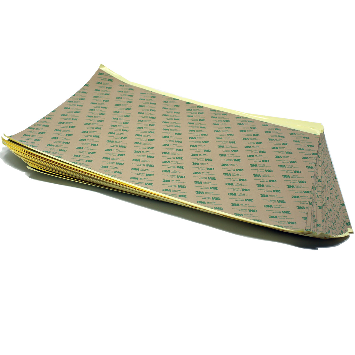

For any kind of layered project I use a double sided adhesive instead of glue. I put it on the back of the full sheet of material, masking removed, then cut with the adhesive applied. Then each layer is ready to be stuck to the next right out of the laser.
For indoor applications I use DualTite:
For outdoor, more expensive 3M brand:
Thanks for the info! The layers have been cut but next time, I’ll try adding an adhesive sheet to the material first.
