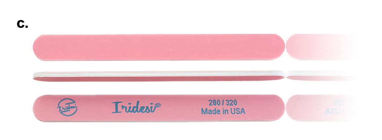

Love these! And love the supply list. I’m still working on the gluing part of acrylic. I tend to get some messiness that is hard to clean up. I see that you use acrylic weld. What is your process for a clean glue up? I’d love some tips and tricks if you have them. Acrylic to acrylic and acrylic to plywood. Really beautiful work!

Clean-up. There should be a minimal amount of clean-up necessary if you’re not using too much adhesive. But on those occasions where the adhesive has made a blob, I’ll work on it after it’s completely dry. If possible, I’ll whittle the blob off with an xacto blade. If there are blobs around the edge and not on the front surface, I’ll buff that smooth using acrylic fingernail buffers (C - 280 320 grit emery). This will leave a matte surface, so if you want it glossy it has to be polished. I don’t have any experience yet with polishing acrylic. Even though I know it can be done, I imagine you can’t get into small gaps well.
