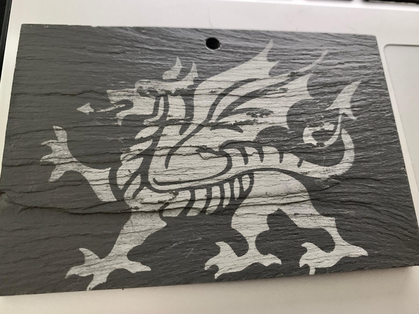

I did this one yesterday. Minwax oil-based poly.
I did these yesterday with a shellac coating. These are those exact coasters. I did them one at a time, using the set focus. (don’t mind the fibers–they’re left over from the twine I was using to tie them together…).
