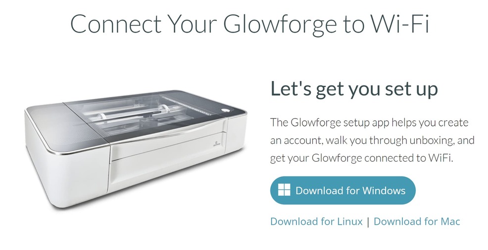

i’ve tried. the only thing that mentions setup send me to a page that has me downloading a launch program. then nothing

There IS software to download. You’re gaslighting this poor guy.
Chrome version 100 and later does not support the way Glowforge used to run the wifi setup. It can no longer be done in the browser.
If you visit the Glowforge setup link in a Chrome browser, you will be prompted to download a new software installer. The software installer is used to do the wifi setup that used to happen in a browser.

It appears that Glowforge changed ownership of both printers to me, yet didn’t set the second one up. When I’m logged in, the drop down menu for printers only shows one. I have downloaded the GF software several times yet it doesn’t launch anything that helps me set up the second printer.

Your problem seems to be that the software isn’t working on your computer. Run it on a different computer, or set up the printer from a phone or tablet. Once you have it set up, you’ll be able to control it from any device.
Ok I’ll try another computer.
I ended up loading the setup on my phone and it worked. Thanks for the suggestion. Things appear to be up and running.
