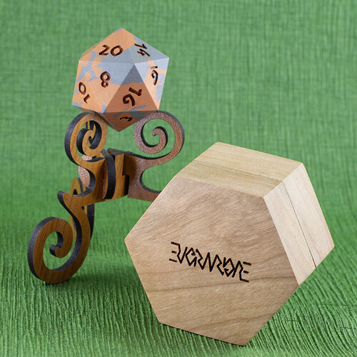

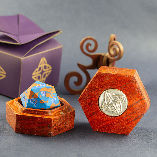

Another of my “touched by a Glowforge” projects.
These boxes were cut on a Nomad 883 desktop CNC machine. I used the Glowforge to make tooling to get the lid pockets centered (shims and a “practice target”), to engrave my Evermore ambigram on the bottoms of the boxes, and to cut headliner fabric to line the interiors.
More photos and spin videos of the finished boxes on my blog:
There is a 6-minute process video, if you are into such things. Linked timecode index in the description, if you just want to see the laser bits.
