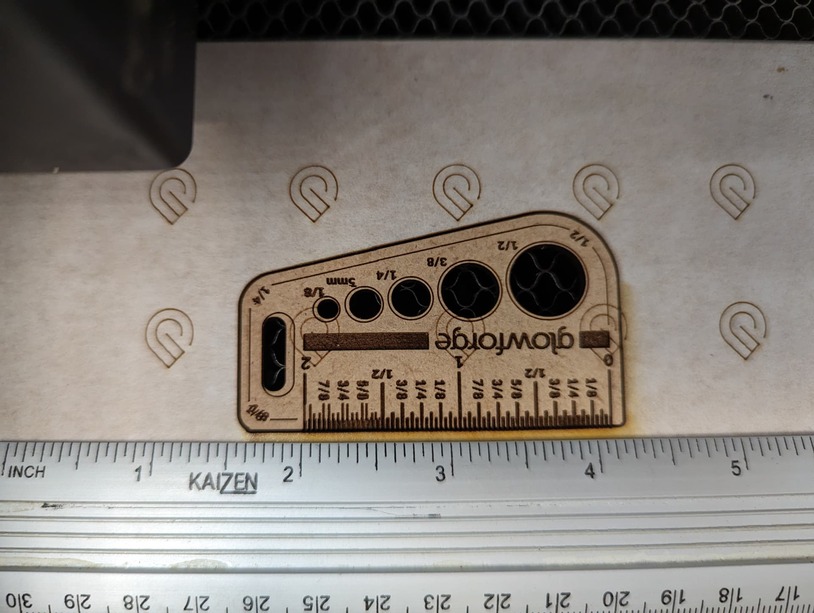

I have had a similar issue in the past. I am printing a 4x6 photo, first step is to cut the shape out. I thought it looked “off” when I took the 4x6 shape off the bed to peel the masking before engraving. Put a ruler to it and the vertical measured 4 like it should but the horizontal measures 6¼ish instead of 6.

Here are GOGM images one printed each direction.

So this is strange. I had two operatign theories, and I think my second is pretty good, but then I got thrown off when I looked closely at your defective GOGM pic. Why does it look like it was done twice? Particularly in the lower left corner, there’s a weird ghosting on the 1/8":

Let us know what’s up with that, did you run it twice or something? If not I have a pretty good idea what might be happening.
I only ran the GOGM once for each orientation.
Huh then my best theory is that your belt wheels in the x-axis are your problem. This definitely looks like a motion control issue, you have all kinds of misalignments. I think your x-axis is both slipping and missing steps. Here’s some evidence to support it:
The order of steps in the GOGM is engrave the measure marks, then score the circles, score the oval and other pieces, cut the circles, then cut the oval and outline. You have evidence of slipping/missing steps at every stage.
  • In the blue oval, you can see evidence of missed steps in the X-direction by how the measurement lines are “jagged”, they have steps to the both the right and left.
  • The pink arrow points to the 1/8" radius label on the lower left. There’s ghosting, like it was printed twice, which makes no sense. You can also see this in the large measurement ticks up to 5/8", you have two copies of each. Maybe reset your design in case you accidentally duplicated that part of the design?
  • The green oval shows that there’s a mismatch between the cut circles and the scores. Hard to say if the scores are misaligned here yet or if the cuts are later. I suspect it may be both but generally slips and lost steps happen as speed increases so the score (300 default speed) would be more likely than the cut (168 default speed)
  • The orange oval shows that the score for the oval hole is very far off from the cut. Again, hard to say where that went wrong, but the fact that it’s a different offset from the circle cuts in the green oval says that whatever the problem was it was getting worse or at least changing at this point.
  • The blue arrow shows that the cut was also impacted by the problem. That corner should be a smooth radius, that lump is a sign of some sort of problem.
Beyond that, the variation in measurement tick distance (note the red lines showing areas where they were closer together at a suspiciously “1 diameter of the wheel” distance makes me wonder if your wheels could be somehow out of round. It’d be weird, but this is a weird problem.
So, yeah, I’d do two things: Reset the GOGM and see if that resolves some of what you’re seeing, and then try to isolate those belt wheels to see why it’s binding, I can’t help but think that it’s the root cause. Look carefully at the wheel bearings, the screws involved, the belts, the teeth in the wheels (if any) etc. It’s gotta be in there somewhere.
