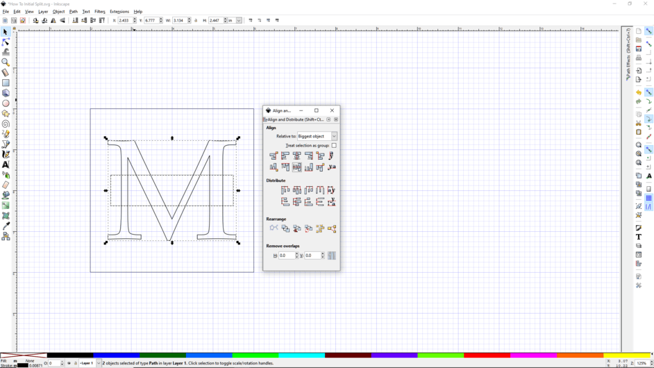

Align the letter to the bounding box. Select both object by rectangle selection tool dragging around, Ctrl + a to select all, or hold shift and click on both. Use the Object > Align and Distribute menu and dialogue box and keep it open. Center on Vertical and Horizontal axes.
Make 3" by .75" rectangle, convert the shape to a path and align it vertically and horizontally to the letter.
Click on the rectangle and press Shift + d to duplicate in place that rectangle. Keep it 3" wide and make it 0.5" high. Align it to the letter vertically and horizontally. These rectangles will be what we use to split the letter and then close the split so there is a line at the bottom edge of the top and a line at the top edge of the bottom.
