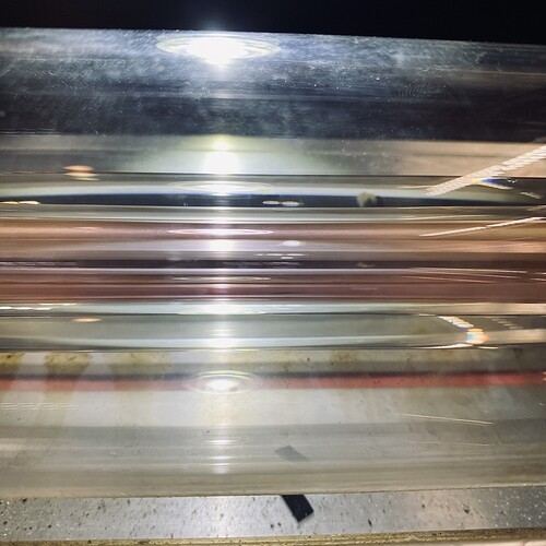

I went to use my glow forge after a month of not using it due to my day job. I saw condensation inside the machine lid and water under the honeycomb bed, and thought that water had crept up the exhaust into the machine. After the exhaust apart, there is no moisture in the exhaust tube or where it connects to the body. The inside is covered in dirty condensation so I think the glow forge is totaled. I receive an amber light at every power on. After cleaning and inspecting the machine up and down, I’m fairly certain that the laser tube is empty! That would explain the standing liquid I saw. I’ve sometimes noticed small bubbles moving in the tube on start up but I see absolutely nothing now. I know the coolant is optically clear, but I think it’s just empty. I opened the reservoir and dipped some q-tips in to check the level and they came away wet. I’ve manually moved the gantry, aligned the print head with the camera, reseated the laser head, reset the glow forge (teal button setup) Any ideas?

As for the bubbles in the laser tube, you should only see that on first power up and you should not see them once the coolant has been fully cycled through the lines and tube.

The system is self purging, and nary a bubble in mine for years. If you do see bubbles that suggests either a lower than normal level in the sump or a leak in the system.

Go ahead and try your best to remove any remaining condensation with a dry rag, that would be most helpful. If you could also send over a photo of the laser tube I can go ahead and confirm if there are any problems with the coolant.
