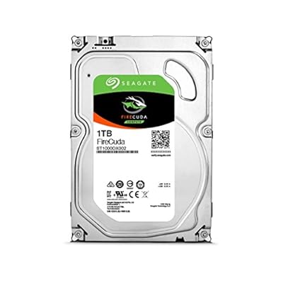

the cheapness of a HDD is tempting as not too much money on hand(the 09 is only SATAII so 50$ will get me a 1TB replacement). Though double the money will net a SSHDD hybrid drive. Don’t think I can afford going full SSD nor would I see much benefit in doing so as it’s been a couple years since I’ve had to do any real video editing. The most I do these days is convert video using Handbrake. (though don’t get me wrong, if I had the disposable income…a nice 2TB SSD would be nice, but it’s 4 times the cost)
Only fun thing now is when I get the new drive, I have to utilize the only one to boot up into recovery mode to make the new one bootable and install via internet. Undecided if I’ll keep it a clean install and go through the effort of finding all the programs to install(i’ve got all the .dmgs around somewhere) or load the latest Time Machine image.

As much as a WD fanboi I’ve been over the years(I’ve built many PCs and never had one fail on me though a buddy of mine who also builds has had a bunch over the years), I believe the price and 5 year warrenty on this one has won me over.

If I were still doing video editing I would absolutely spring for a full SSD but as I’m just hosting a substantial iTunes movie library to stream to my appleTvs the cheaper HDs really are a better option(also bought that 2Tb drive about 5min after finding it on Amazon). The only thing I use my iMac for anymore is video conversion via Handbrake and that would benefit from a CPU upgrade that I don’t need or am able to afford either. The joys of building up debt then going unemployed for 7 months. Had 1 job for 7 months and a second for 4 and am seeing the light but still pretty buried.
