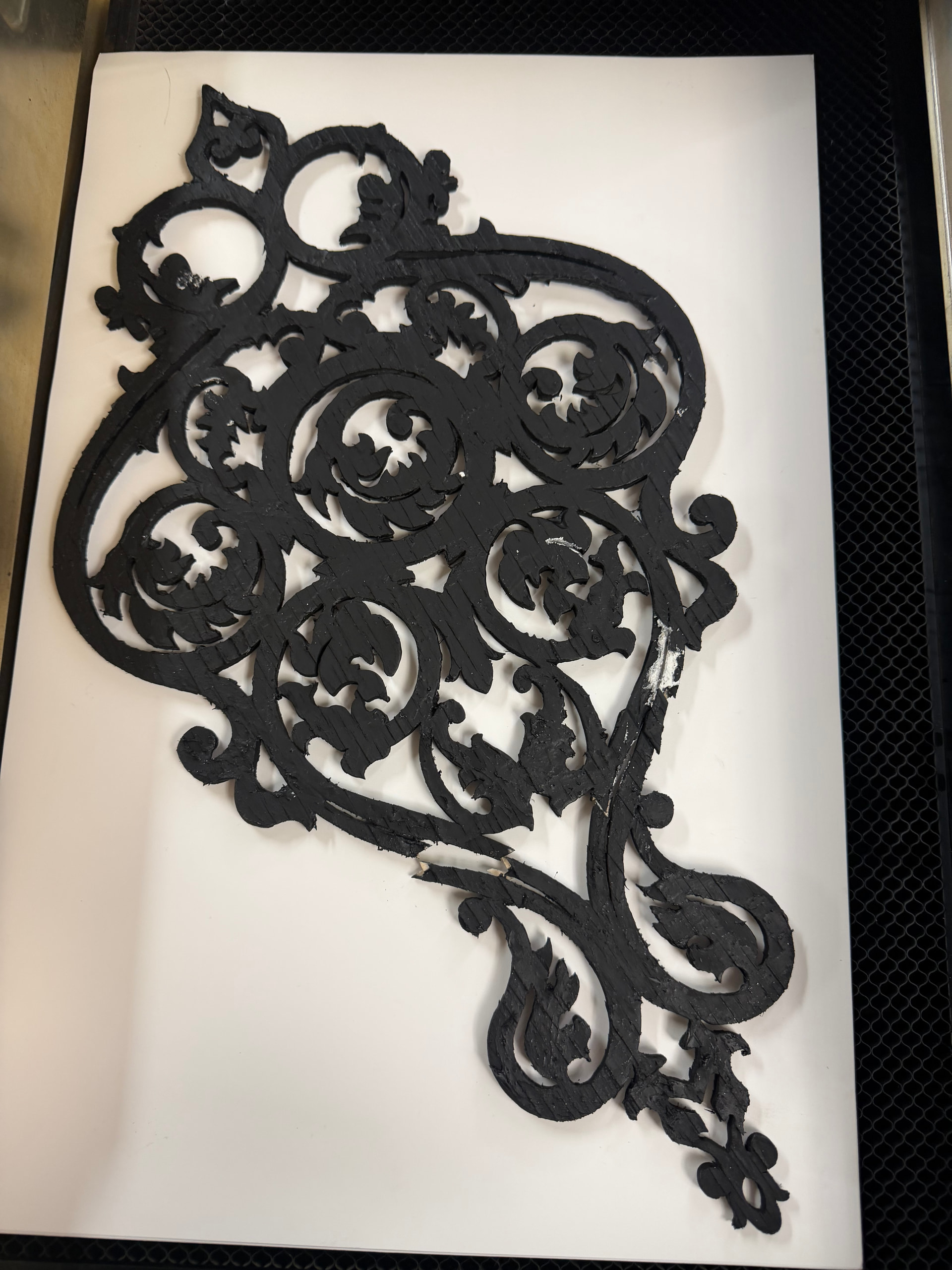

I am trying to capture this using the glowforge camera and then cut on acrylic. I can not get a complete scan, especially of the middle. Any ideas?
If it were me, i’d scan and ā€˜repair’ in a different program…parts of the design are missing and the GF won’t ā€˜fill’ that in.
I’d take a brightly lit photo from above if you don’t have a scanner large enough (my old printer could do 13ā€x19ā€, though current one can only do 11ā€x17ā€). Then import it into your software, like Inkscape, then do a trace to convert it from a raster, and repair what you need.
