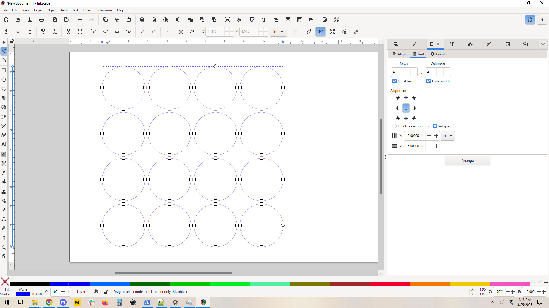

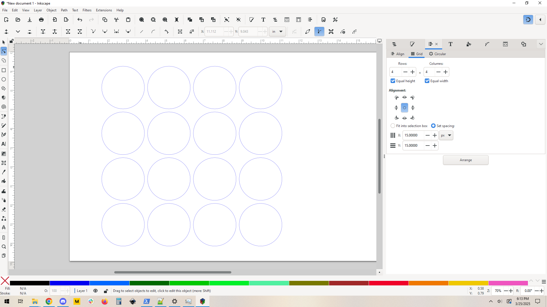

What does it look like? Let’s say you have this grid of circles. One of them has an open path.
In the past, you’d have to go digging in the nodes to find them, it’s a manual process and not very fun. If you’ve done this, you know what I am talking about. If you’re an eagle eye you can spot the problem nodes, go ahead, see if you can find them.

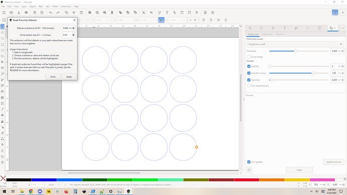

Using the extension, the nodes are easily found.:

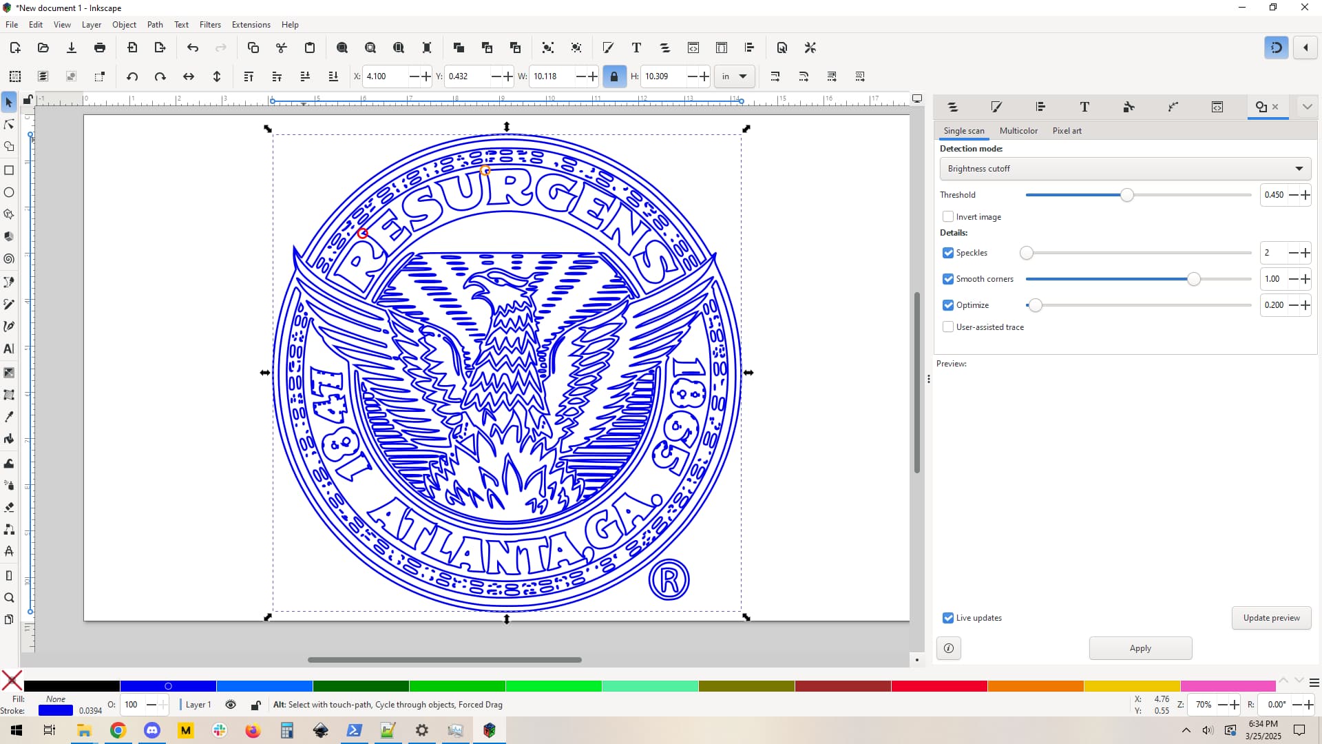

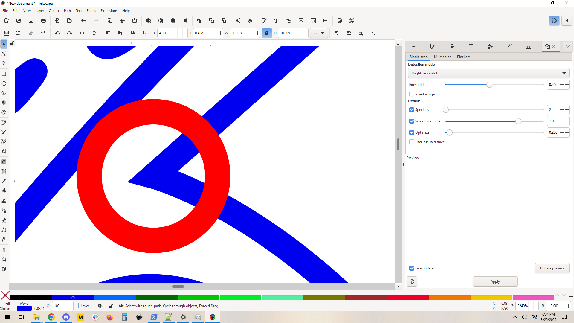

So that’s one relatively simple example. The more common use case will be more complicated. Take this trace:

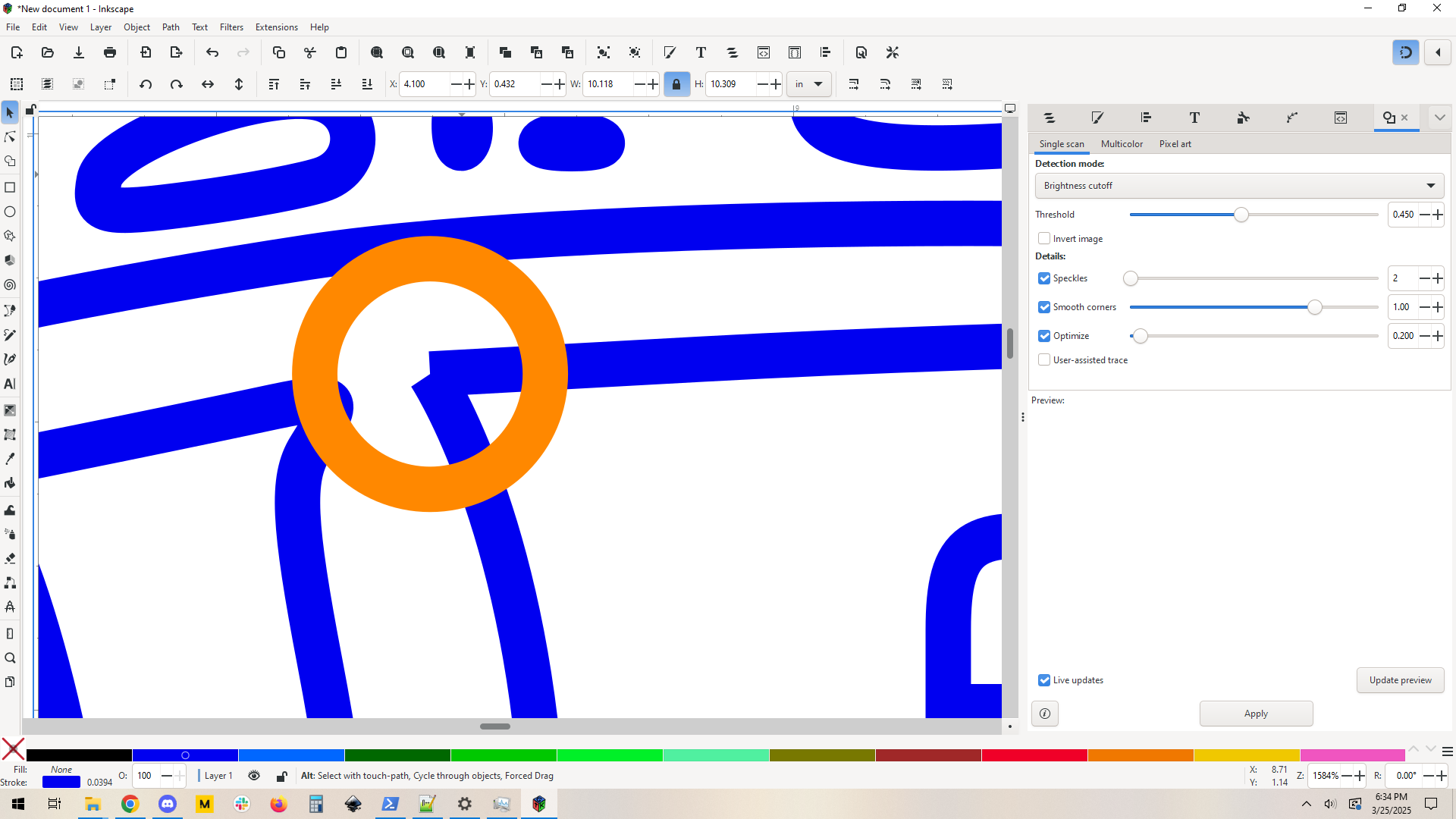

Tis is a complex path, and there are many places it can go wrong when tracing or doing something like stroke to path. Running the extension finds two places where the path has a doubled up node, one closed (red) and one open (orange).
Zooming in:
This is an early beta and it may have bugs. Please help me out by trying it. It’s been reasonably well tested but SVGs are complicated with lots of edge cases. It’s very possible that it might fail if you have a complex or unusual SVG.

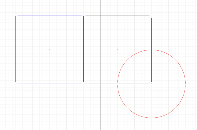

Kind of a weird use case but it would be very useful to me when cutting out foam board for RC planes to have squares and rectangles exploded into lines and arks with about a mm of separation .
Give me a before and after of what you’re trying to do

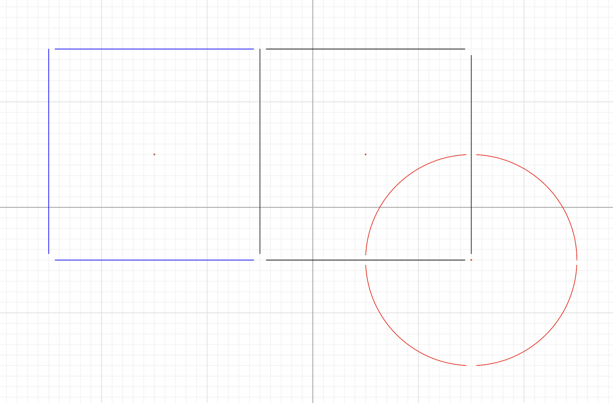

before
Sketch9
after
after
I didn’t finish the after as it is quite tedious to do manually, but you should be able to see I am a)breaking the path, and then b) setting the path back just a bit. This way I can color code the paths for cutting and several types of scoring.

What I would really like is the reverse tool - which adds short gaps so I can make tabs/bridges to hold pieces to a sheet.
I think what you want may already exist in Inkscape: a custom dash pattern so you can convert dashes to segments.
Does this solve your issue?
Not really, what I ideally want is 1 tab per item. What I would really, really like, is to be able to select a segment of a line, click the button and get a 1mm tab on that line.
Lightburn has an automatic or manual tabs feature which works well for cutting, except I do all my designing in inkscape.
You can pull it off with my other extension, improved cut path.
I’ll write up the workflow when I get a chance later today.
