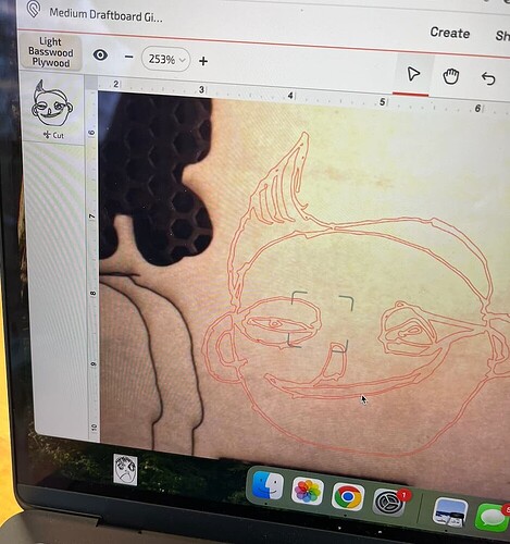

What is HAPPENING!? I have had this machine for about 9 months. I stopped using it out of frustration for about 4 of those months. I am trying to cut out and engrave these little drawings from my class. (Yes, I know this is not the recommended model for an educational setting but I am not planning on giving it that kind of a ride, and it’s all I could afford.) Sometimes it works great and then I start something else and its a mess. Same settings, same proof grade materials… I clean the rails, EVERY use, I use every trouble-shooting method in the chats. Sometimes I use the exact same settings, same images, 2 totally different outcomes. Sometimes it cuts all the way through, sometimes it doesn’t. The worst is when I walk away and come back 20 mintues later and the image is “off.” I have wasted so much teacher time and money on materials for this. :frowning:
I don’t know if you are requesting assistance or simply venting. Either is ok. The first thing I notice about this project is that for each picture you are cutting before engraving. I urge you to reverse this because when an item cuts, it can drop down and the engrave will be off. The second thing is you should not walk away for 20 minutes.
I’m trying to find a solution to why this KEEPS happening. It happens even if I don’t “cut,” just engrave. You can see that the bottom "cut is off, and thats all it’s doing, cutting. I’m in the same room with the machine. “Walk away” means not staring at it.

UGH, I could seriously cry. I came back to this project this morning. Unpluged and replugged the machine, cleaned the rails, used proof grade materials…I gave it a full fresh start. And I got this craziness. What is happening!?
Sorry. I attached the wrong image. LOL.

This thread has gotten a bit confusing. In one photo they have it set to cut AND engrave,
then the next photo shows just cutting…so I’m not really sure what the problem is.
My gut reaction is though that it’s something wrong with the printer.
