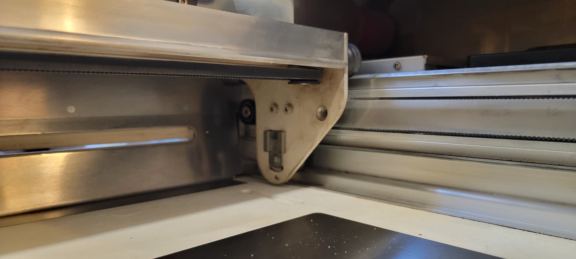

Hello,
The gift of good measure is printing out on proofgrade maple plywood now.
I just tried to do a score on leather using proofgrade settings with some text and it came out really bad this time.
Please see the attached.
Here is the proof of good measure which to me looks really good :
The score lines on the Gift of Good Measure look smooth to me - unlike on your text. Perhaps try the same text score but at a slower speed.
It’s strange that they are still jagged even though I used proofgrade settings.

Hi @jotinpro My name is Mercedes and I’m part of the Technical team here at Glowforge. It’s possible that it could be your belts, could I have some photos to review?
First, power off your Glowforge and remove the crumb tray.
1.The belt under your laser arm with the head pushed to the left:
2. The pulley under the laser arm on the right side from the front:
3. The right side pulley under the laser arm from underneath:

Your belt looks good from what I can see. Can I also have you check these wheels on the carriage plate for any cracks or bumps and abnormalities?
This suggests that you could be having trouble with a wheel on your carriage plate.

It looks dirty, but ok. I took this off to clean the fan on it. This issue has happened since then.
Hi @jotinpro
Thanks for checking your wheels and sending over those photos, your wheels look great!
I spent some time going back through all of your previous photos. And while I think your belt looks okay, I can also see that it might need to be tightened a little bit more.
vs
I would say before we go ahead and order you a new belt since you have already tightened it as much as you can let’s try shortening it as well and see if we can get some improvement.
​​I want to get you back to printing right away. Since this belt can’t be adjusted to the correct tension, it’s likely that it has stretched over time. You can shorten the belt by opening up the belt clamp on the carriage plate and trimming a small section of the belt. You’ll need a 3mm hex key , pair of scissors and a measuring tape for these instructions.

So I did this and tried the text file from 29th and it was about the same.
Can someone else try the text in this file at 200 speed score and see if it also has the same issue?
