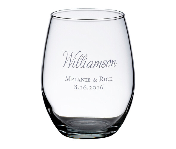

True for many shapes. Thankfully most drinking glasses are either cylindrical or conical. It would be hard to get a mask onto a wine glass though. :disappointed_relieved:
Well, it’s not as easy, but it’s possible…I did a really nice circumferential deco-style design on a 10" diameter curved globe fish bowl one year. (It was a gift so I never got a picture.):slight_smile:
You have to be a lot more careful to make sure you get the edges of the mask sealed down, but it’s definitely doable. Wine glasses are possible as well with the right mask. (I think I used frisket film on the bowl.)
That frisket film looks like good stuff! Does it stretch?
I could see maybe masking off one or two of these, but I couldn’t see myself being willing to do more than that. My hat is off to anyone with that kind of skill! (and patience)
Actually… I think I would have to be the one getting married to try that with a mask. Phew! I’d love to learn some tricks to do it if it’s not as hard as it seems.
Chuckle! Yeah, masking tiny script takes real dedication! (For that you hire an engraver.):smile:
(No the film doesn’t stretch. You can use adhesive vinyl, which is a bit more flexible, but you can’t cut that with a laser…you’d need a craft cutter.)
Couldn’t you just paint the glass with a resist of some sort that is soluble in water or a solvent, etch through it, then dissolve it away later?
Oh duh, you are talking about lasering the mask flat and applying it to the glass after. Sorry, disregard my last idiot idea.
Most heat transfer vinyl is, in fact, not vinyl and is laser cut-able. I plan to experiment with that for heat transfer purposes when I get my GF. In the meantime, I’ll experiment with using some of my HTV scraps cut on my Silhouette as masking for glass etching/sandblasting.
