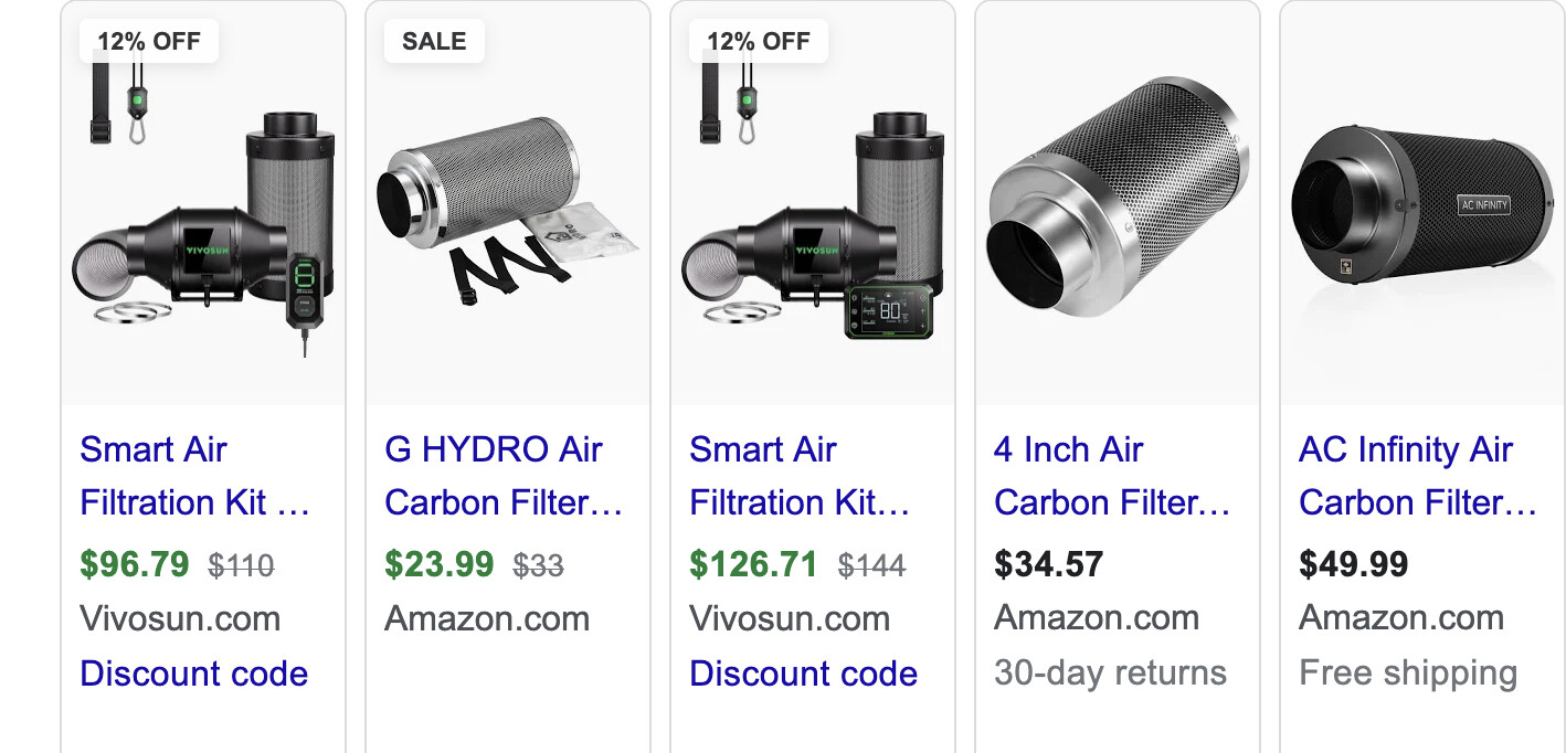

It sounds like you want something like a charcoal filter that may change the smell of the exhaust, but doesn’t really stop the particulates the way a filter does. This allows you to vent outside, but may make you a better neighbor.
