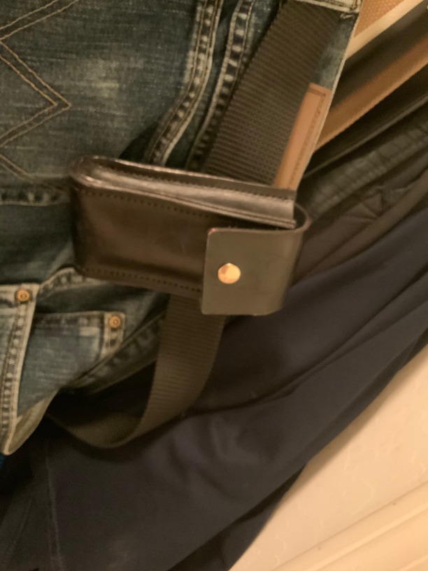

I bought my GF with the idea of leather working. so far I have engraved luggage tags. not an aggressive start years after getting BEAMER.
I never thought about the template idea. Duh… I clearly would be making multiples of things. and this would speed things up. So thank you for this info!!!
Ok, sorry. Total newbie here. This was my first post. I should take the time to read the rules. Duh!
As a very stingy member with meager supplies … just what it came with and a little wood I would rather cut it from cardboard and score it into the leather to have a cut line. This design won’t be made again as it is specific to my husbands multi tool (unless he doesn’t take care of it well). Thank you for your advice. It is very much appreciated!
No apologies necessary. There is lots to wade through, and most of us just want answers. Keep reading, keep posting and keep forging.
If you go this route you can also score a light line directly on your leather with the GF and save the cardboard step. I’ve done this for one offs - but I do prefer @Tim_Ung’s method of making an acrylic template for anything in multiples, it works so nicely with a rotary cutter.
Here’s how it turned out. Thanks for all the advice
