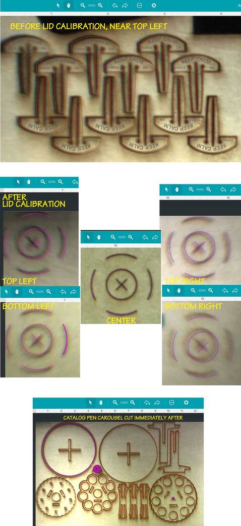

Mine went from “pretty good” to “still pretty good but slightly different” ![]()
Not quite as perfect in the corners as some have reported but close enough for what I have in mind at the moment. For example: I’m confident I can put those carousel pieces back in to personalize if needed.

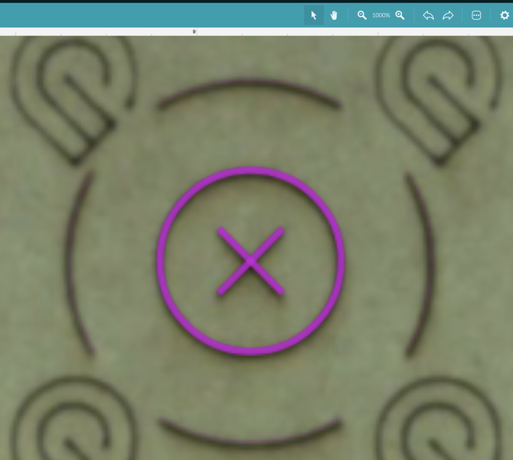

Here are some of my test sequence images:

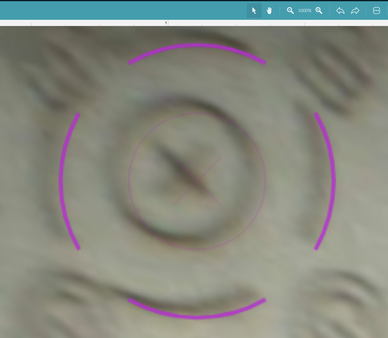

This is top left. Is this an acceptable level of alignment? All images are zoomed at 1000%
Here is dead center:

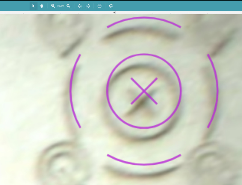

Here is far right at the top:

Hi. Thanks for your reply. I tried the calibration 3 times. Each time, all goes well until I go to the last step of checking the accuracy of the camera. As before, it is fairly accurate under the camera but becomes more inaccurate the farther away I print.
