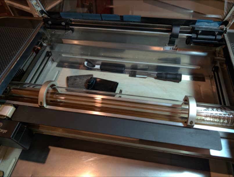

Finally fixed my lid!
Here I’ve detached the black cable/strip, removed the lid, and carefully removed all the old glue.
I next removed the back/top strip INCLUDING the hinges and removed glue from the matching side. (And took no useful pictures.)
Then I cleaned with alcohol and used JB Weld Clear to join the parts. Since I removed the hinges it was easy to join the sides once glue was applied, still detached from the Glowforge.
After curing I reattached the hinges (and now attached lid).
So far so good!

I’ll keep an eye on it, but it’s rock solid so far. I’m hopeful that my thorough cleaning of the surfaces and my more generous coverage will make this glue job last beyond the life of the other components.

So that’s what a clean tube looks like…I haven’t seen mine that way since I got it.
It was SO filthy; I normally just wipe clean a small window as a gauge to how long it’s been since my last lens wipe!
