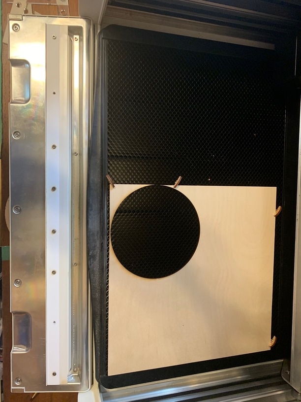

My lid is not closing all the way. It’s up just a bit, maybe 1/16" or so. Hasn’t caused any issues that I know of, the machine is still working fine.
I think the issue is that the front flip down door is resting on the front handle of the crumb tray. If I remove the tray it closes fully. The tray is sitting in its divots and is the correct orientation.
I’m not really sure what else to try here, but is this expected behaviour, or have I done something stupid?

Thank you all for the replies. I have shimmed my GF and it has helped a bit. I did a bit more poking around, and it seems that the metal pass through guard is interacting with the front handle on my crumb tray. When I close the front flap I can see the tray slide back a little bit and the flap is hard to close. If I take the guard off the door closes smoothly, the tray stays put, and the lid is level. Kind of weird.
Thank you for the update and additional information. As a next step, may we have two photos of the door of your Glowforge while it’s open? Please take one photo with the guard in place, and the other with it removed.
Hi Ivan,
Is this what you’re looking to see?
If not just let me know. I was assuming you were referring to what I have been calling the “front flap”.
Thank you!
Thank you for posting those photos.
I’m reaching out to the team and will update you as soon as I have more information.
