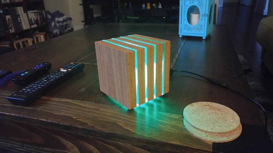

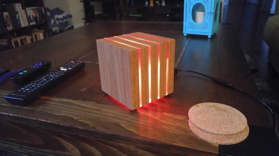

Ok Here is the image dump of what I did!
I started soldering a bunch of 3 LED strips together but got so frustrated with the process that I completely changed gears. I think this actually works nicer and the time spent was minutes instead of hours soldering all of the pieces.
This approach was a little hacky, but this idea came out of a moment of pure frustration after I accidentally burnt out one of the LEDs in my chain with the soldering iron. My best ideas come when I’m frustrated I guess!
I took the tube I had from my heat shrink tubing (probably 1 1/2 inches in diameter) and cut it so it fit the inside of my cube. I then covered that in aluminum tape to make it a little sturdier and used the adhesive already on the back of the LEDs to stick it down.
I then cut little notches so the LED controller is inside the tube with the two wires for power and the IR receiver sticking out. I then glued the whole assembly into the cube, added my 3D printed feet and did a test run.
It worked better than I had anticipated and the glow is pretty much as uniform as I could ask for!
I didn’t paint the inside white like suggested mostly because I didn’t have any white paint kicking around. I plan to build another one of these so maybe I’ll try the white on that one!
Pictures don’t do this thing justice. It turned out way better than I could have hoped! Thank you all for your input!

The glow underneath really does look fantastic.I particularly like that the table reflects the stripes of acrylic so it looks like they just keep going.

@Dunfee, did you do anything special to the acrylic to frost the edges and diffuse the light?
I sanded the whole thing with my preferred finishing sanding grit for woodworking, 320, which some people would call excessive. I noticed when I did the oil finish it made the edges look clear(ish) again so I went back and hit only the acrylic edges with 320 again.
If I was to do this project again I would use something other than just epoxy to bind it together. My roommate at the time in her infinite wisdom put the cube behind a curtain next to an open window so the moisture got to it and the wood warped forcing the whole thing apart. If I had used metal bolts I bet I could have kept the thing together much better.
