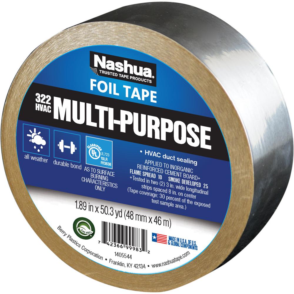

So I started to tape the junction of the GF exhaust and the vent duct and I noticed little dots that looked like pin holes in the duct where the foil of the tube bunches to allow flex. I removed the tube and looked inside, sure enough little pin holes of light near both ends where the most flexing has occurred during installation. I cupped my eye against the end of the tube, held it to the light and I can see micro holes the entire length like a starry sky.
I guess I will need to go buy some semi rigid 4" duct pipe.
Edit: I have since purchased a new semi-rigid duct pipe. With the old one removed, I filled with water and the holes do not leak. The layers of polyester are doing their job and keeping the tube air tight.

It is likely not an issue for something like a dryer. The included duct feels very much like it is a metal foil of some kind. The kink points of the bunches where it accordions is where the holes have formed. They are very small, I almost missed them. The duct on my dryer is more of a Mylar type material and might be a better option for the included duct.
I will likely just pickup one like this: https://smile.amazon.com/Deflecto-Connecting-Flexible-Semi-Rigid-HUPK8WA/dp/B000IJTBFS/ref=sr_1_12?ie=UTF8&qid=1497539653&sr=8-12&keywords=dryer+vent
It is a much heavier gauge aluminum yet still will allow me the freedom to move from place to place as needed.

Flexible ducts are horribly fragile, and inefficient IMHO. I don’t even use one on my dryer. Just moving them around too much starts breaking the foil down. It’s far too thin. Can’t expect GF to include hard ducting though. This gets a person going, and honestly, since the GF doesn’t throw out all the junk a dryer does, if it’s not moved a lot, it will work fine for most.
This is the stuff in case someone hasn’t seen it before. Seal around everything and if you’re going into a fitting that has a seam, do that as well.
