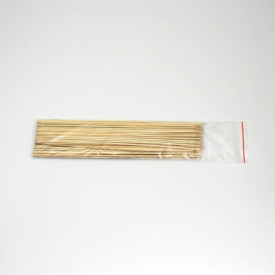

I have found bamboo skewers to be much better than toothpicks as the larger diameter is both strong and turns easily if the hole is just a bit big and a spot of glue works well where you do not want it to turn.
