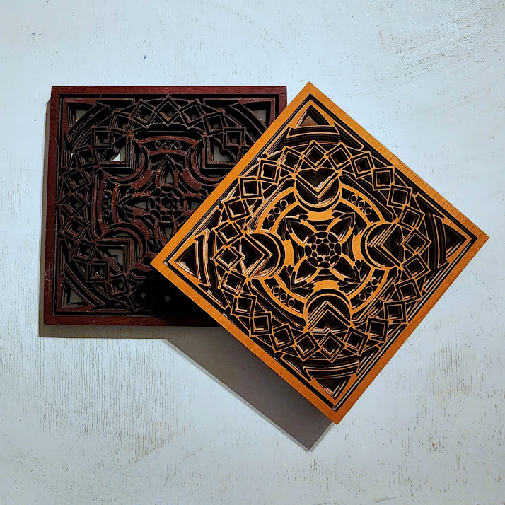

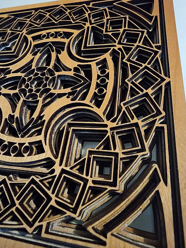

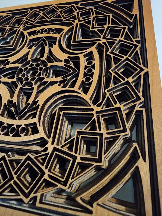

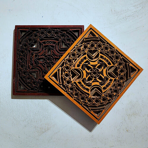

Inspired by the catalog mandala I went down a rabbit hole of layered mandalas, and emerged with this.
It’s 4 layers - and that top layer is quite delicate. If I made it again I’d probably glue with wood glue again, but also (after finishing) hit those top pieces with some superglue…or fill the entire thing with resin :slight_smile: We’re using it as a trivet and I’ve already broken the 4 halfmoons off (you can see it in the picture).
This was cut out of four layers of 1/16th purpleheart using PG medium basswood hardwood settings, glued with Elmer’s, and the outside edges sanded down to plain wood. Then the entire thing was finished with tung oil cut with mineral spirits.

Wow! I mentioned patina in your other post with the Lunar New Year tiger…but, this one has such a great burnished finish to it, too. Really lovely.
Tung oil is amazing stuff - it brings out all the depth in your material. It takes forever and a day to truly dry even when cut with mineral spirits, but it’s absolutely worth the price of admission.

I can’t believe your mandala is only 4 layers. It looks like much more. The dark wood gives a rich look too.
