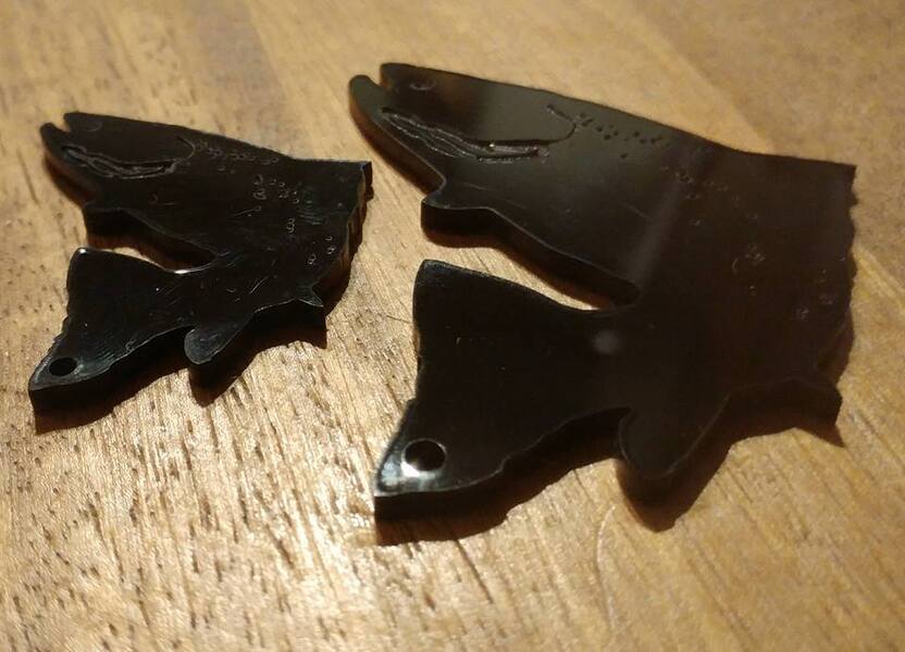

Just throwing out my test for comparison. The edges have a slight lip after cutting, but nothing like the original pic. It’s a very different look as well. I know you did it without the masking so that’s not it, but I does look like something on top if the acrylic got hot and distorted it. So strange. :-/ Wish I had an answer for you, hopefully the GF team can figure it out.

@PrintToLaser @smcgathyfay It happens with any file I use. Just to remove the question of it being my design, I just ended up using the rocket cupcake topper from the GF catalog.
@kittski I don’t think the cut that you posted looks good either. I did mine with and without masking. Without masking is worse because it also leaves the honeycomb imprint but with masking is equally bad around the edges when I run it.

I’m wondering if the heat from the beam is causing the plastic to expand, creating that lip you’re seeing around the edges as it cuts. I’m curious whether or not a moist paper towel might help keep it cool (or cool it faster) after the beam has cut it, preventing that lip from swelling.
I agree, the edges on mine should look better, but it still looks better than your mess :confused: Mine is at least usable. Hope they get it sorted out. I cut several other colors the other day, I’ll have to check them carefully when I get home to see if the edges are the same.

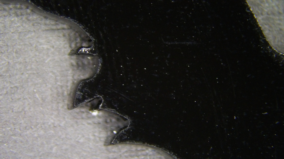

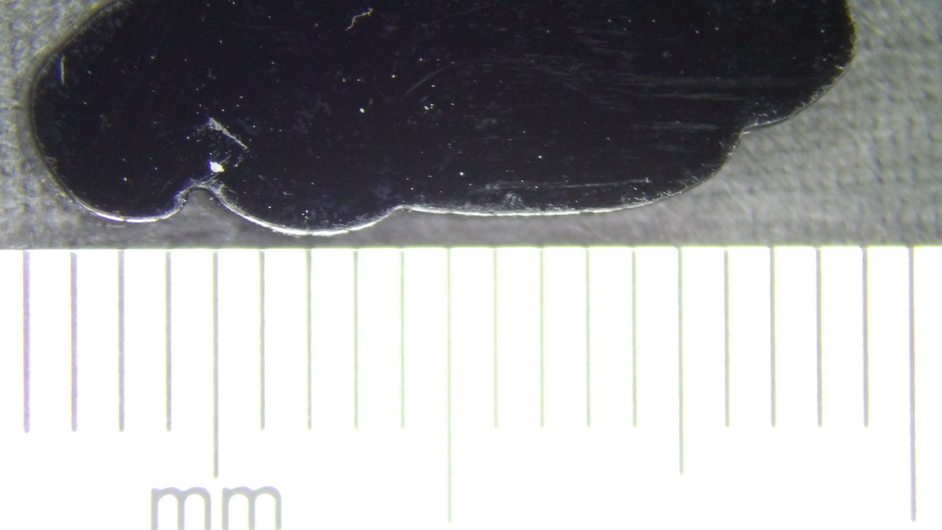

Just adding my pennies to the fire. I had an opportunity to cut some black PG acrylic today, so I figured I’d check out the edges. They didn’t look noticeably bad, and I had to examine them under the microscope (literally) to see melty edges. This is on a Pro, no setting tweaks. I don’t know what to make of this, other than further evidence that the issue is not universal or not consistent.
