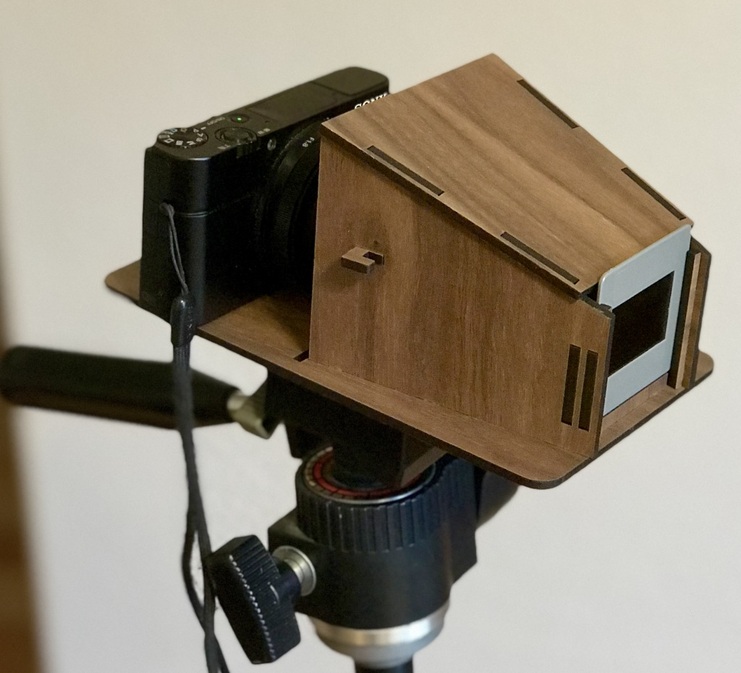

On a related photo subject, I used the Glowforge to make a couple different versions of a slide copier/digitizer. Some versions could accommodate both a digital camera (I tried several cameras) and iPhones. The results were pretty good with all of them, and my Sony RX100 with 20.1 MP images were comparable to those with my iPhone 7 plus. Minimum focus distance on all the cameras and the iPhone meant that the slide image area didn’t fill the frame of the phone or camera, so the resulting images had to be cropped. Macro settings didn’t seem to help much. One advantage all of them was that I could focus on the center of the slide image to set the exposure. Also, when using the iPhone, the digital photos showed up in “Photos” on my iMac soon after, and I could quickly crop and enhance them. For my light source, I pointed the copier at my iMac screen where I had a big blank white rectangle on the screen. Overall, results were surprisingly good and better than results from a slide digitizer I had bought on Amazon. Anyway it was a fun project, and I copied many hundreds of slides- which I’ve now discarded. Of course, many of the original slide images weren’t great, but had sentimental value, and some Kodachromes dated back to the 1940’s.
Sony RX100 copier

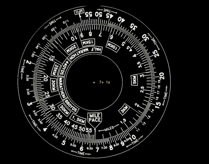

Updated version of old pace computer project- made on my Glowforge

Okay, I have never seen a time/speed/distance calculator just for runners before just now. Even though I don’t run it is inspiring as the concept could be applied to any paced activity.
